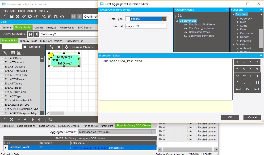

I can see that the PIVOT Aggregated Formula is where where each sum is calculated.
So, I try to use the condition “case” in the Pivot Aggregated Expression Editor.
But if I put ANYTHING in there that mimics what I’d use in a calculated field the syntax is rejected on the first item.
(case when… will error on ‘(’
case when… will error on ‘case’
What I’m trying to use is:
(case when Sum(LaborHed_PayHours) > 40 then Sum(LaborHed_PayHours) -40 else 0 end)
Can anyone explain what I should be doing in the Expression Editor?

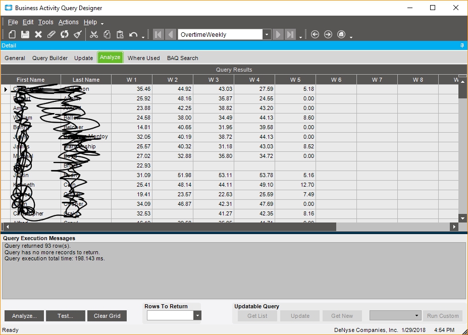

Here is the working query phrase from the first screen shot:
[SubQuery1].[EmpBasic_Name] as [EmpBasic_Name],
[SubQuery1].[1] as [SubQuery1_1],
[SubQuery1].[2] as [SubQuery1_2],
[SubQuery1].[3] as [SubQuery1_3],
[SubQuery1].[4] as [SubQuery1_4],
[SubQuery1].[5] as [SubQuery1_5],
[SubQuery1].[6] as [SubQuery1_6],
[SubQuery1].[7] as [SubQuery1_7],
[SubQuery1].[8] as [SubQuery1_8],
[SubQuery1].[9] as [SubQuery1_9],
[SubQuery1].[10] as [SubQuery1_10],
[SubQuery1].[11] as [SubQuery1_11],
[SubQuery1].[12] as [SubQuery1_12]
from (select
[EmpBasic].[Name] as [EmpBasic_Name],
(DATEPART(WEEK, LaborHed.ClockInDate)) as [Calculated_Week],
[LaborHed].[PayHours] as [LaborHed_PayHours]
from Erp.LaborHed as LaborHed
inner join Erp.EmpBasic as EmpBasic on
LaborHed.Company = EmpBasic.Company
And
LaborHed.EmployeeNum = EmpBasic.EmpID
and ( EmpBasic.OTCalc_c = True )
where (LaborHed.ClockInDate > ‘01/01/2018’ and LaborHed.OTEX_c = False and LaborHed.ClockInDate < ‘12/31/2018’)
group by [EmpBasic].[Name],
(DATEPART(WEEK, LaborHed.ClockInDate)),
[LaborHed].[PayHours]) SubQuery1_src
PIVOT
FOR Calculated_Week in ([1],[ 10],[ 11],[ 12],[ 2],[ 3],[ 4],[ 5],[ 6],[ 7],[ 8],[ 9]) )
as SubQuery1

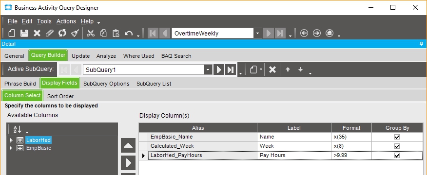

My issue is that I’m not calculating any hours in the subquery.
I’m referencing the employee and the PayHours record and a Calculated Field is finding the week number:
The Pivot aggregate is summing the hours by week number. That’s why I was trying to apply a condition to the top level.
I am trying to add a calculated field in the subquery, like you suggest, but evaluating each record as greater than or less than 8 hours. I’m dealing with individual time records in the subquery. That is not giving me the results I need.
I’m no longer showing one line per employee.
Ben
Sorry…
Here are the results after I switch the PIVOT aggregate from the Sum(PayHours) to the Sum(MoreThan8).
The individual number are making the 8 hour evaluation. But the sum per employee per week is not working.
Ben

But if you look at the first screen shot you’ll see that I show the weekly total hours per employee. I need essentially the same with only overtime hours per week per employee.
Example my hours are W1 is 40.5, W2 is 39 and W3 is 44.
I want to show for me W1 = .5, W2 = 0, W3 = 4, etc.
That for each employee .
