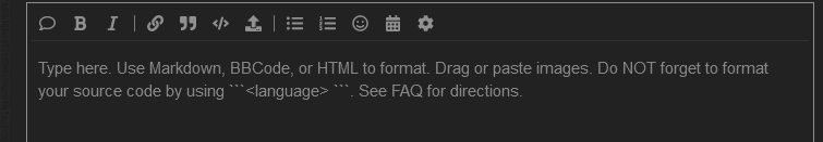

And if anyone can guide me as to how to format my code better for forum - I think i may have it all distorted.
It’s just 3 backticks (the key to the left of the 1 on the keyboard) before and after your code.
I updated your post for you, if you go to edit it, you can see where I added the 3 ticks. One line before your code started, and one line after your code started.
