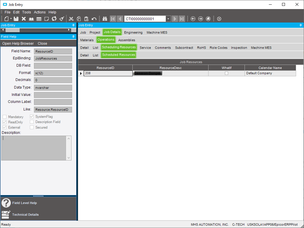

BAQ to return scheduled resource on a op 10 of a job
As you can see in the screenshot the binding for this tab is not straight forward.
Would anyone know how in a BAQ I can reference a job, an op in that job, the op detail for that op and find what resource is scheduled so that I can return the resourceID?
Eric

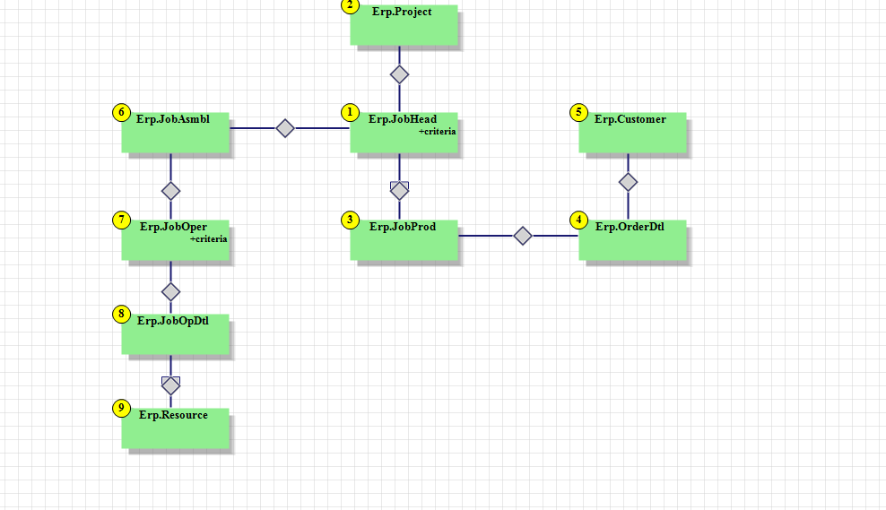

I have got a dashboard for this, here is the BAQ, it maybe contains things that you don’t need to link. so just trim it to your need.
111-ScheduledResource.baq (41.3 KB)
Erp.ResourceTimeUsed has which resources are actually scheduled for a particular operation. It contains the JobNum, AssemblySeq, OprSeq, REsourceGroupID, and ResourceID. It may also have the OpDtlSeq, but I’m not sure of that off the top of my head.
thanks tyler! That table had the exact info I needed.
