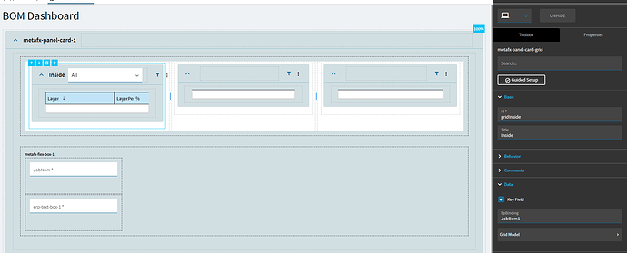

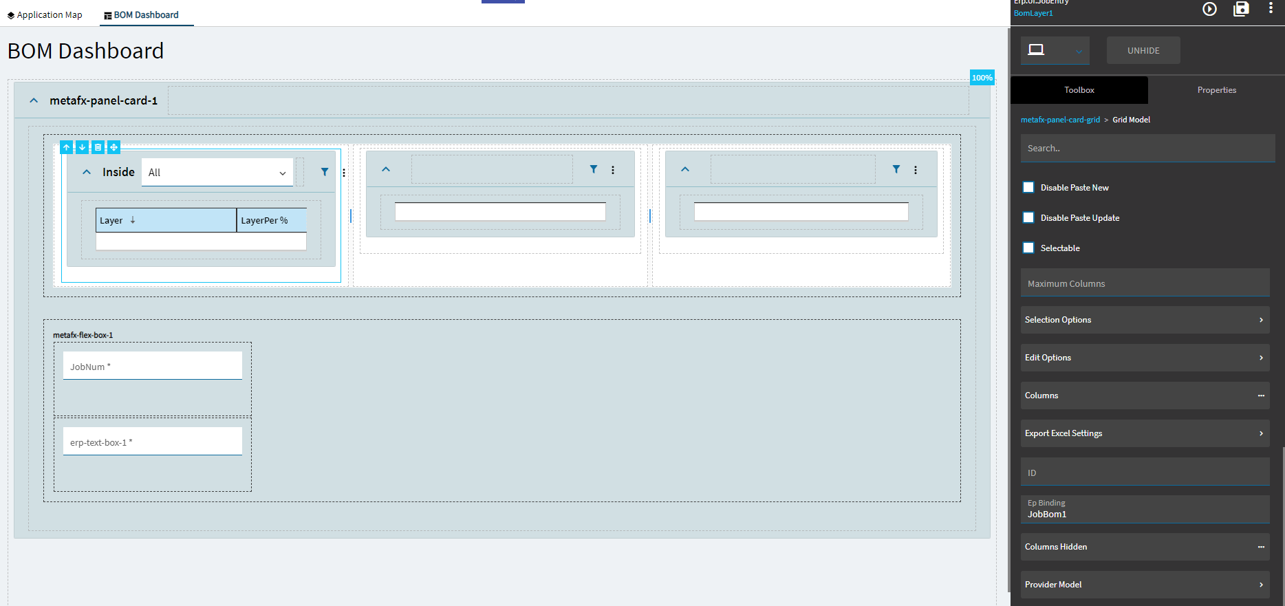

Here is one of mine, as an example:
Grid Properties:
Grid Model:

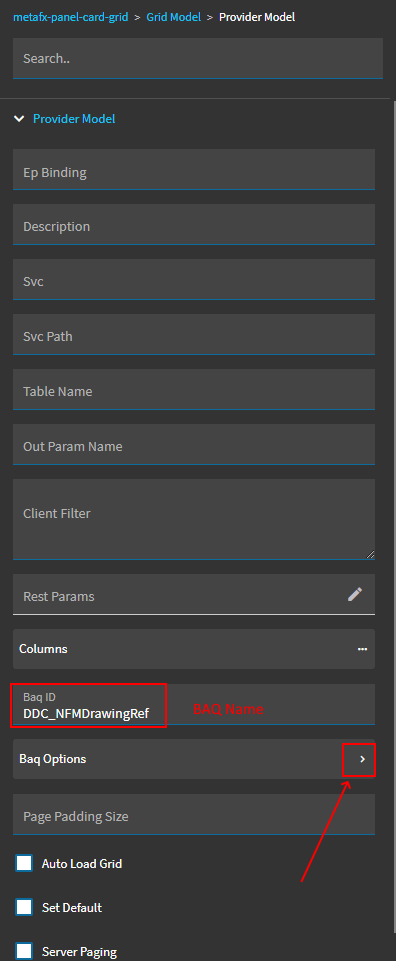

Provider Model:
Baq Options:

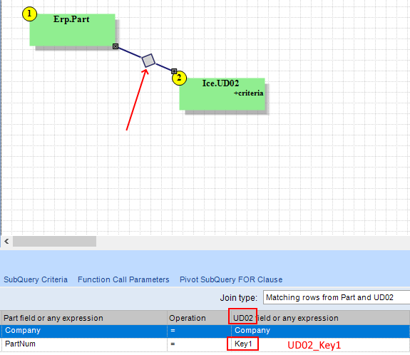

Here is my BAQ (showing my link of UD02_Key1 = PartNum):

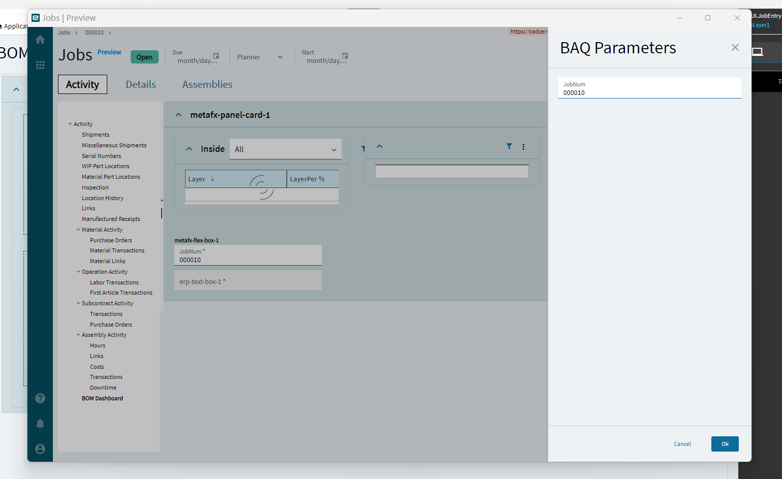

Hello
I got popup.
regards,
Eddy

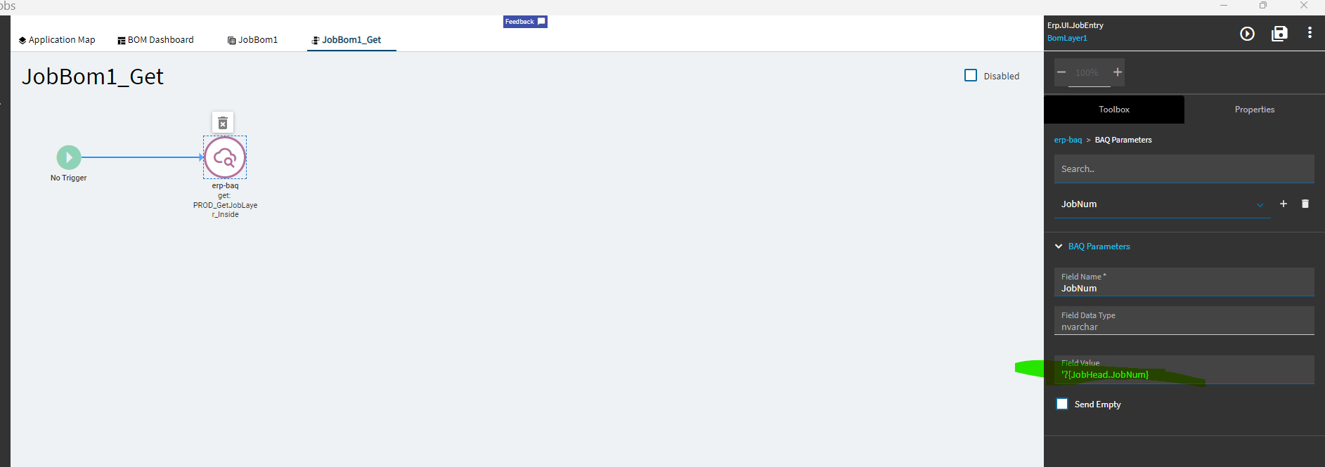

Do you have that Parameter built into your BAQ? You may need to delete it.
In the BAQ, you’re asking the user to enter the JobNum to get the results. In the dashboard, you want that value to come from the KeyField of the Job you’re already looking at… so you don’t need the BAQ Parameter at all (no user input required).
So, I would edit your BAQ and remove that parameter and see if your grid populates.
thanks a lot,
it works and my dashboard is working too in kinetic.
