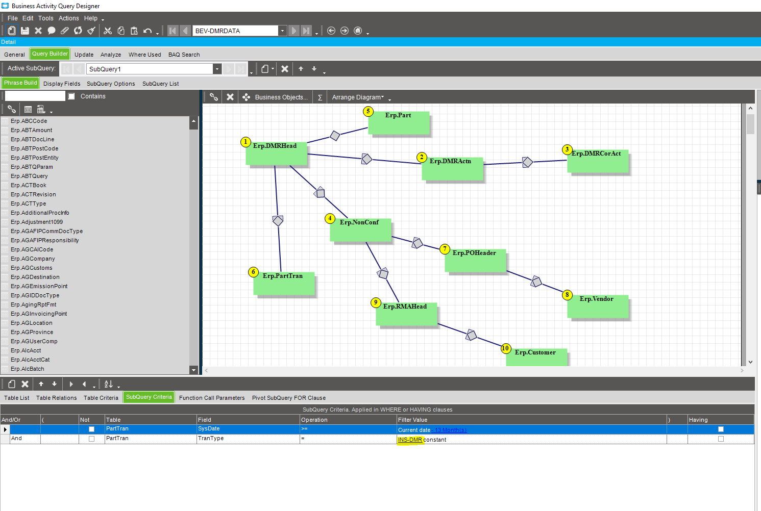

I see that there is no “open date” or “closed date” fields within the [Erp.DMRHead] table (and records are written to this table precisely when a DMR is “initiated”). The [Erp.DMRActn] table is merely a tracking of records that illustrate what actions are taken on a specific DMR; and those actions have nothing to do with “opening”, or “closing” a DMR. The [Erp.PartTran] table provides some clues that I might be able to leverage (such as the [Erp.PartTran.TranDate] and a [Erp.PartTran.TranType] of “INS-DMR” to perhaps indicate when a DMR has been opened), but I am not confident that I would be referencing this data accurately.

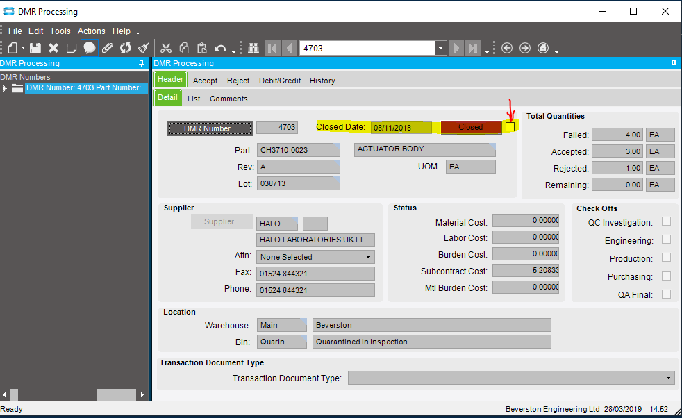

you are right TranDate or SysDate is your DMR open date for TranType INS-DMR, and as @enbw mentioned you need to create a UD field on DMRHead to save the date when closing DMR method triggered, i have already done this for the same purposes, and created a BAQ/Dashboard to get all needed information to built the KPI metrics/Reports for our Quality Department

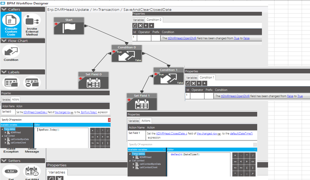

this is my BPM if you interesting, you only need to change my UD field name by yours
SaveAndClearClosedDate.bpm (28.2 KB)
Thanks very much for being incredibly generous, Al. I was just about to reply to the thread to ask you what XML tag in the trace log would indicate that the DMR has changed from open to closed. There seems to be a lot of interesting information about the part transaction under “Erp.BO.DMRHistoryDataset” and “Erp.TableSets.DMRHistoryTableset”, but nothing is specifically jumping out at me (could merely be poor eyesight).
From your BPM example, it looks like I didn’t set up the logging correctly (or didn’t think the matter through properly), perhaps - as I see it’s a simple monitoring of the changed value in [DMRHead.OpenDMR]. Makes perfect sense.
Curious though… why the additional step to check the field a second time for a value change from “false” to “true”? Might that be in case a data entry person discovered a mistake in closing the DMR and decided to delete his/her previous effort to close it - thereby, reversing the status of the DMR back to “open”?

with regards to second step is to cover the case when user reopen the DMR as Close date will be irrelevant on this case, so the BPM will clear it and update the relevant one when DMR get closed again

Using the information you had offered concerning BPMs on the DMRHead table, I was able to recreate that in my environment and it was rather easy to implement. I’m sure Epicor has specific reason for not adapting those important data points directly in the DMRHead table (I can’t guess why open/close dates would not be important enough to track), but having them readily accessible has given me exactly what I need to provide insight to the Quality team on simple things like “Open DMR” reporting.

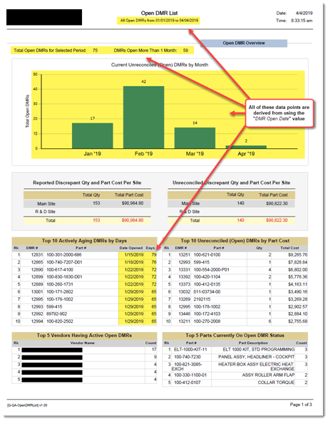

Here’s an example:
I can now show when a DMR was opened (and is still open) for aging and DMR volume metrics across specific time frames. Very useful.
So - thanks again, Al. You made me look good!
