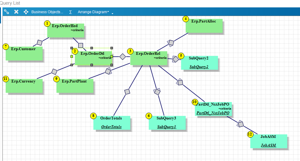

I’m trying to build a “FULFILMENT DASHBOARD” of a sort. Modeled after the fulfillment WB, I have a pretty ratty looking build that I have to clean up for a concept.
I was initially testing it filtered to one order. But now that I opened it up, it will not TEST and just sits “EXECUTING”
I rebuilt the query of a sort inside SQL (minus some minor top level calculations that were failing) and it returns 16K rows in about 16 seconds and the BAQ test is still executing for 30 minutes now (I doubt it’ll run)
BAQ have some limitations that I don’t know about? Or are there any suggestions to get it to run?

This is the query that I dumped into SMS

Try removing the company link between customer and orderhed there is a known bug in 600 that can get you there. Add a condition on customer with company = CurrentCompany.
See what you get.
Tried some of the customer links. Looks like it hates what I’m trying to do with the part DTL subquery to return the first ranked row (next due PO / Job Num)
I’ll try to adjust some things around.
I would try to use a BAQ Parameter that you can pass to all of your subqueries to limit the table scans for each subquery. I would assume that you are doing full table scans on some really big tables right now.
You mean like a open = 1 inside the subquery, or the TOP?
I think I got most of them looking at a specific set, but I’ll doublecheck it all.
@Andrewpech Another thread on this kind of issue below. Things to try. Check the execution plan in SSMS. I had to add an index for a baq and it made a huge difference. Also, option recompile could help.
If it runs well with PartDtl out then you could try to get the next PO in code post processing on getdtl instead.
BAQs make me want to day drink…
Just needed to dump a couple subqueries from the phrase build table and re-add.
:man_facepalming:
Perhaps you had a bad cached SQL Execution plan? Odd. So you are saying that you deleted the subqueries and re-added identically?
I have found that open joins for the
Customer to Order head, currency to OrderDtl, part plant to orderrel, etc. actual will speed up the query.
Also, try to use PartDtl, it might help with some of the information required and reduce some of your sub-queries.
Not really even the subqueries… But just the subquery tile on the TOP query.
I checked 20 times to make sure I didn’t have something funky in the relationship.
Agree. PartDtl is such a wonderous table! Its central to a lot of the queries I’m writing lately.
