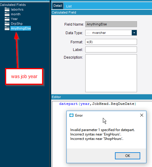

So I’m trying to create a new calculated field that is uses the same functionality as another field already in the query.
datepart(year,Orderdtl.NeedByDate)
This is what is already in the query working fine. What I want to do is the same thing with the JobHead.ReqDueDate. Should be simple enough.
Whenever I add the new field, no matter what date I put in there I get this error
It doesn’t make sense, the exact same syntax is already running fine. If I delete the field, everything works fine. If I add it back in, error. If I just add the date with no datepart, then it runs (not what I need, but it runs)
Can anyone tell me why I am getting this error?
quick stab, change the name of your calc field?
Same error.

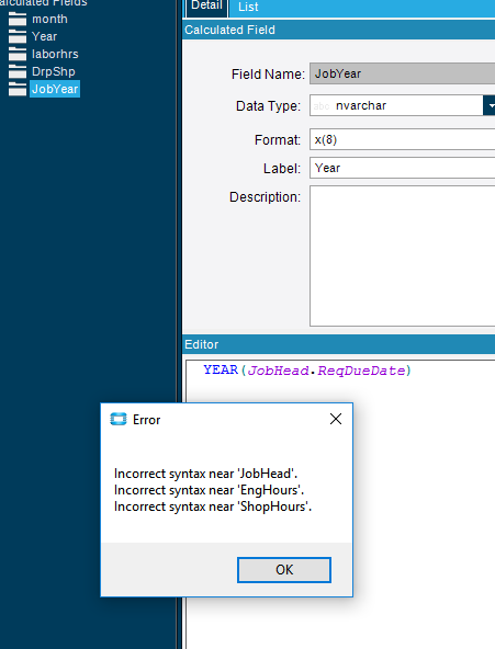

Try this.
YEAR(JobHead.ReqDueDate)
I have a feeling there is an error in another calculated field, the query runs fine before you try to add this new field?
I’d say share the entire query so the gurus can see how it’s configured
Yeah, it runs fine until I add this one.
Same error with that code.

The data type should be int.
still doesn’t fix the error.
And it does this, which I don’t want
Start by just putting “test” with x(8) format and see if it still gives you the error. If so, then it sounds like a corrupted query. You could either try exporting-importing, or rebuilding it fresh.
I’ve seen this mostly in E9, but there are some bugs I’ve seen over the years in this interface.
I can add new calculated field with just characters in it. (that’s what you’re suggesting right?) it’s only when I try to add the date part that it throws the error.

Brandon, if you’ve tried pasting in the exact same datepart formula and it fails where it is working in another calculated field. This suggests to me some sort of internal corruption in the BAQ. Try to re-create from a new BAQ and see if it still gives you the error. I have seen this before, and sometimes this is my only recourse.
