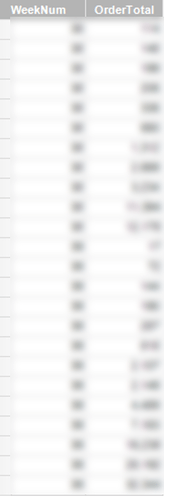

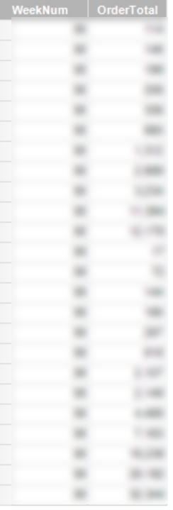

I am attempting to create a simple BAQ that returns the sum of all orders by week and year. Currently it returns two columns with the week and order was added and it’s respective total value, see below. I was unable to find the DocOrderAmt field and had to create it as a calculated field. How do I group by week number and year?

@abill9 , @abill9 's query is correct, but I will add that you probably want to add the year in there are well and group by the week num as well as the year. Otherwise you will get all of week# 1 regardless of which year it is.
Secondly, Blurring out your all of your results while trying to ask for help makes it pretty hard for people to help you. It’s pretty hard for someone to tell what results you are getting other than it’s 2 columns.
