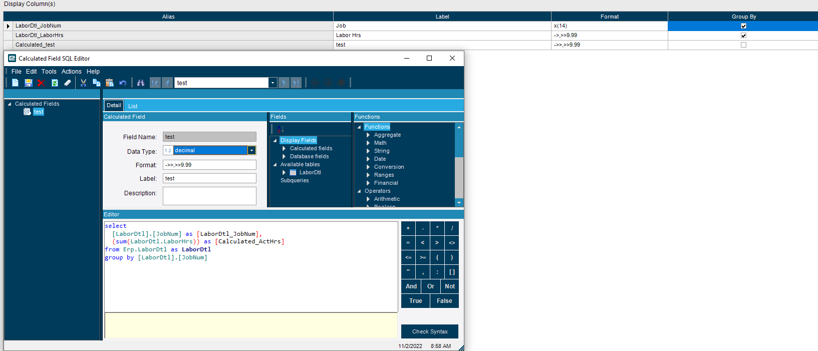

You need to group by your job num. Remove the act prod hours from the output fields, and instead put in a sum field to aggregate the values. I pull the values from LaborDtl. Something like this should work:
select
[LaborDtl].[JobNum] as [LaborDtl_JobNum],
(sum(LaborDtl.LaborHrs)) as [Calculated_ActHrs]
from Erp.LaborDtl as LaborDtl
group by [LaborDtl].[JobNum]
I am new to calculated fields/SQL. I am still having some trouble. I created a simple test baq with only labordtl jobnum and laborhrs to simplify things. Should I be doing something with the [Calculated_ActHrs] in the second line? I receive an error stating bad SQL statement when I test the BAQ.
