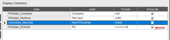

How would I retrieve the PONum on a grouped by Max/Min PODetail.DueDate. The query will find the PO with the Max/Min DueDate but I want to also bring in the PONum but NOT have it grouped by PONum. Can this be done to associate the PONum with that Max/Min DueDate’s PONum?

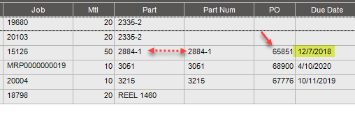

Basically the Parent table is JobHead and I want to link it based on the Part Number to the PODtl table where it finds all PO’s with that Part Number and then pull in either the max/min PODtl.DueDate and also bring in that associated PO Number but is not grouped by PODtl.PONum. Looking to find the earliest open PODtl.DueDate for that Part and PONum. Can this be done using a max/min group by?

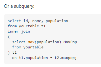

Find max value and show corresponding value from different field in SQL server - Stack Overflow

I was trying to do the SubQuery option but the field I am selecting exists in the t2 table that I need on the max function.
