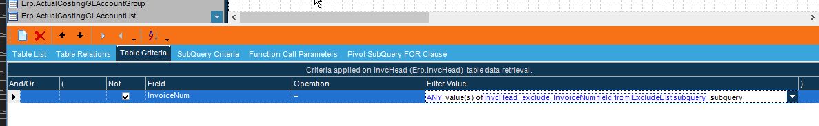

There is also this criteria, that I’ve never actually used. lol. Sounds like you can get a list of the ones you want to exclude, then you can do a filter on the ones that show up in this list? Might be worth a shot.
