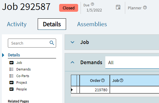

Here is the job number (292587) and the only order that is connected to it on job entry.

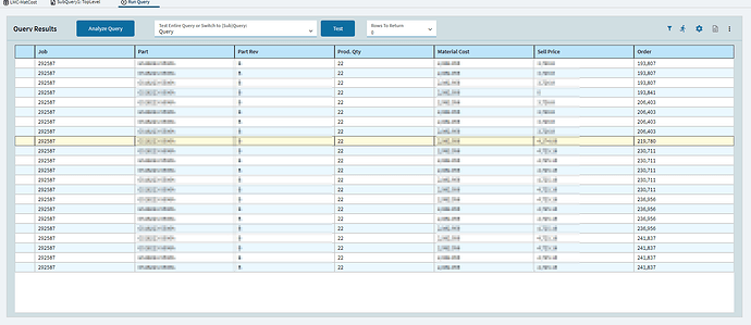

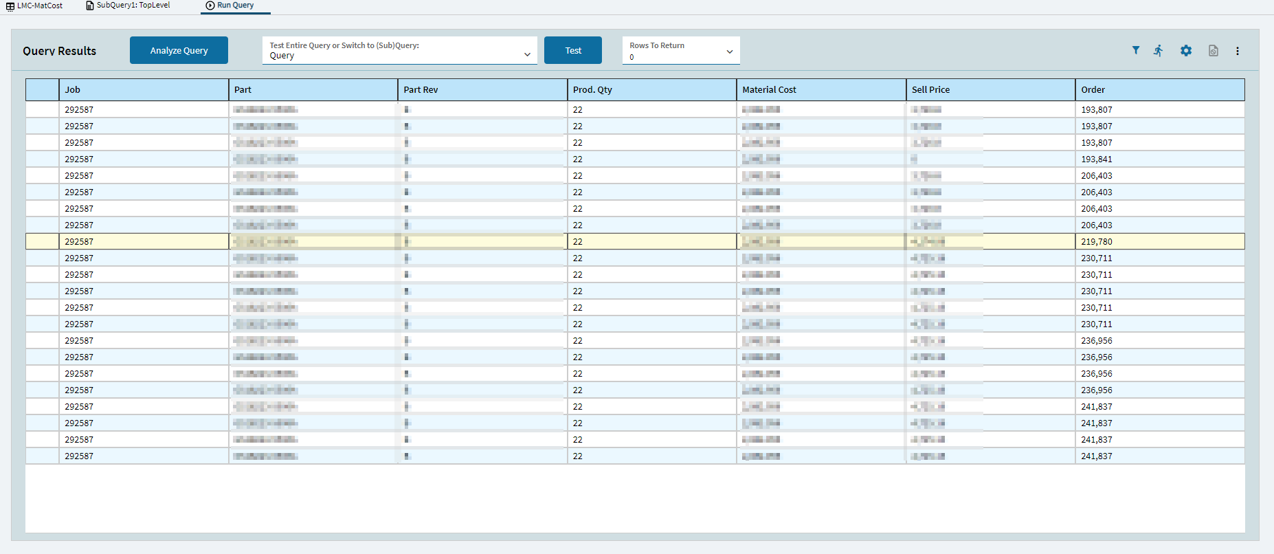

Here is the result of the BAQ. Notice that the highlighted row is the only one that has the correct order number. The rows have mostly identical information, with only the order numbers and sell price being different.

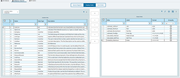

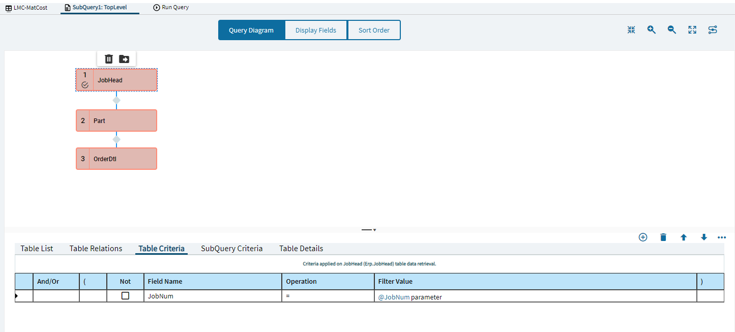

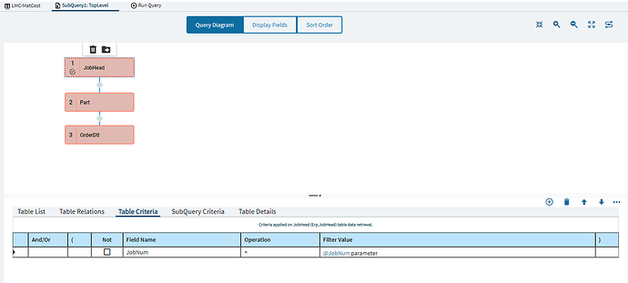

What could be causing this, and how do I go about fixing this? Here is the rest of the information on my BAQ.
Need to tie in JobProd - that’s where the demand data at job level is.
Link JobHead to JobProd, then JobProd to OrderDtl
I believe you should join your tables correctly.
JobHead → JobProd → OrderRel → OrderDtl. This should help to eliminate extra data.
