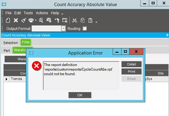

Migrated from 9.05.702a to 10.1.500.11
We are trying to get our 9.05 BAQ crystal reports to run in 10 but keep getting the below error. The reports are copied in the folder \\reports\CustomReports In the report style the path to the report is reports\customreports\
Anyone have an idea what the problem is? Is there another reports\customreports folder we need to move the reports to?
I could only find some documentation and other topics discussing ODBC Crystal reports to 10 but nothing about BAQ reports themselves.
Thank you
Assuming on your server the EpicorData folder is under the C drive. They should be under C:\EpicorData\CustomReports\
