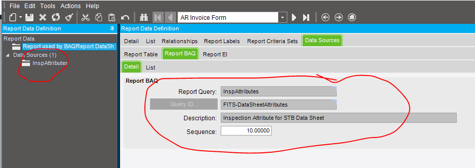

Dears,
I have created a BAQ report and tried adding a BAQ to the RDD that was created with the BAQ Report Designer. after I added the BAQ I went to the Report Style and clicked on “Sync Dataset” button, when I opened the report with Report Builder, the dataset for the added BAQ wasn’t there, it didn’t appear at all.
Could someone explain why it didn’t work? What did I do wrong?
@aamerabuarja, Could you please share the screenshot?
This is the RDD with the BAQ added:
These are the Report Data Sets:
Before you ask, No, the fields from the added BAQ do not appear in the BAQReportResult Data Table.

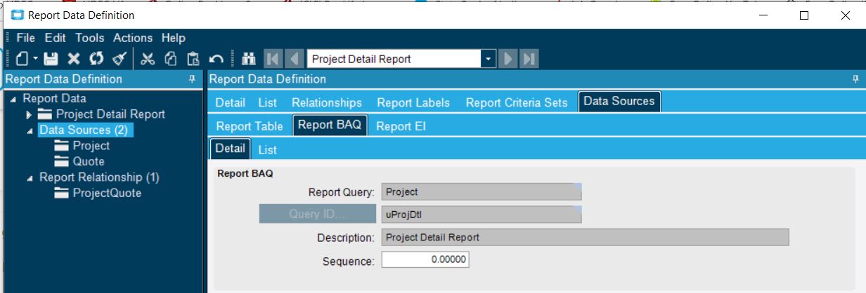

@aamerabuarja,
I have created the BAQ Report Dataset and Report for your reference screenshot is attached.
Please follow the steps in attached word file.
RDD Report.docx (41.9 KB)
