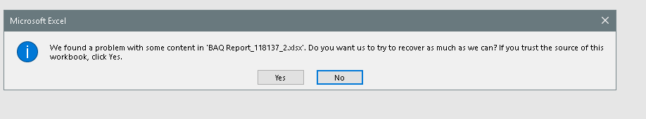

I have BAQ Report that runs fine, but when I run it to launch in Excel, I get the following error:
“We found a problem with some of the content in ‘BAQ_Reportxxxx’ Do you want us to try to recover as much …”

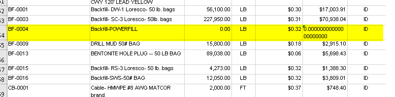

When I hit Yes (to try and recover), I see a couple of things stand out. They always appear to be a line where the QOH is exactly zero. This happens when the sum of the bins is zero (like having 100 LB in Bin 101, and -100 LB in Bin 102).
The values in the report are all correct. But I’d like to fix whatever is causing the excel file that is generated to have that error.

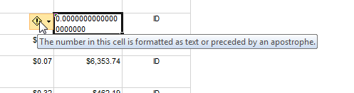

It appears as though the extended value (the column with Excel warning marker, and ‘0.00000000…’ entry) is the issue.
The expression for that is:

After “recovering”, Excel gives the following info on that cell:
The error only occurs when the Sum(Fields!PartBin_OnhandQty.Value) part of the expression is zero.
When the cost used is zero, it works:
