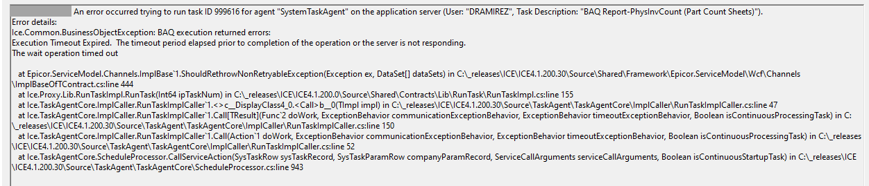

A bit of an odd one here. I have a BAQ that appears to work fine. I can run it wide open in BAQ designer and it executes in maybe 10 seconds. I have an SSRS report that I’ve been working on all day and it’s been working fine… but all of a sudden, as I am messing around with the filters and options, I am now getting an error that says:
BAQ execution returned errors:
Execution Timeout Expired. The timeout period elapsed prior to completion of the operation or the server is not responding.
The wait operation timed out
Any idea what steps to take to troubleshoot? I looked at Event Viewer and viewed the error there. It basically says the same thing.

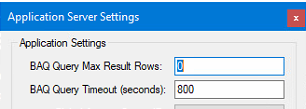

I set my baq timeout to 800 to get around this for one report.

Our timeout was set at 0. Does that imply there is no timeout?
From what I read 0 falls back to the .NET timeout of 30 seconds.
