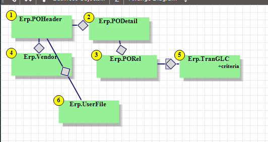

My main query (and currently only), consists of
I want to exclude records when
(PORel.TranType='PUR-STK' and substring(TranGLC.GLAccount, 1, 4) = '1151' )
But only when running this via a BAQ report. The BAQ is also used in a Dashboard, and I want that condition ignored when running the dashboard.
Are you saying to make a sub-query of PORel (left join) TranGLC, containing a calculated field , then join the sub-query to main, and include the sub_query’s calculated field in main query’s displayed fields?
And that should be able to be filtered by the BAQ Report process?
That changes things a bit. Try adding a parameter that you call with you run the report. Click the ignore when blank checkbox so it returns everything for the dashboard baq.
