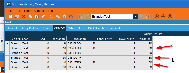

ok, so it’s a bit clunky, and not very elegant, but, I have something that I believe will work.
Here’s SQL if you want to look at that.

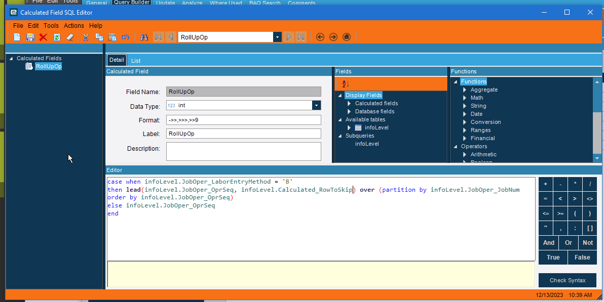

	(case when infoLevel.JobOper_LaborEntryMethod = 'B' then
 lead(infoLevel.JobOper_OprSeq, infoLevel.Calculated_RowToSkip
 ) over (partition by infoLevel.JobOper_JobNum order by infoLevel.JobOper_OprSeq)
 else infoLevel.JobOper_OprSeq
 end) as [Calculated_RollUpOp01]

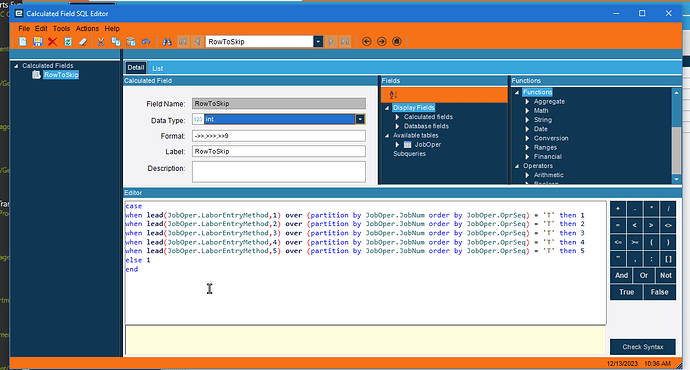

	(case
 when lead(JobOper.LaborEntryMethod,1) over (partition by JobOper.JobNum order by JobOper.OprSeq) = 'T' then 1
 when lead(JobOper.LaborEntryMethod,2) over (partition by JobOper.JobNum order by JobOper.OprSeq) = 'T' then 2
 when lead(JobOper.LaborEntryMethod,3) over (partition by JobOper.JobNum order by JobOper.OprSeq) = 'T' then 3
 when lead(JobOper.LaborEntryMethod,4) over (partition by JobOper.JobNum order by JobOper.OprSeq) = 'T' then 4
 when lead(JobOper.LaborEntryMethod,5) over (partition by JobOper.JobNum order by JobOper.OprSeq) = 'T' then 5
 else 1
 end) as [Calculated_RowToSkip]

But basically, in a subquery, you figure out how many rows you need to skip using the lead function. I haven’t figured out how to let it reference itself in order to keep going, so I had to copy it a bunch of times. If you need more, just copy paste and change the numbers. I can’t imagine you needing more than 5.
Then in the top level use that to get to the row with the operation number that you need.
After that, you’ll be able to make another level and group/sum what you need.
