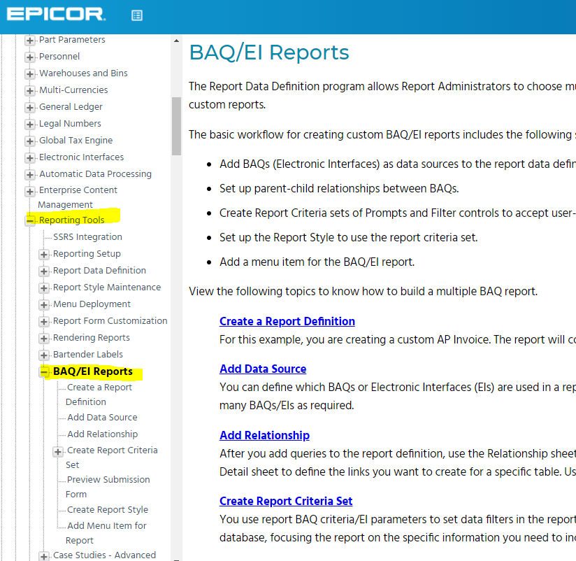

The BAQ Report Designer is considered legacy and should not be used going forward, it has been replaced with Dynamic Reports… so you would create the BAQ still and use Report Style and Report Data Definition to link the BAQ and that allows you to set input fields to BAQ Params.
Or you use the Legacy and use filters.
The Help Section is under this category:
