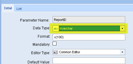

I have a BAQ with a parameter of type nvarchar

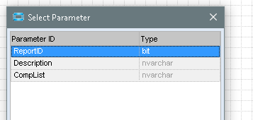

But when I try to use it on a table criteria, The window that lists the parameters, say’s it is of type bit.

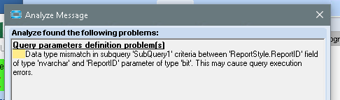

When I try to run or analyze the BAQ, I get:
I tried deleting the criteria row and re adding it, but the Select Parameter window keeps thinking it is a bit
And this was working fine before I added another parameter (which was a type Bit), but then deleted it.
