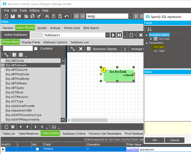

I started a brand new BAQ, defined my 4 parameters, added the first table and a single table criterion with a specified expression. The bit parameters are not available if they are not mandatory.
I’m starting to think it was designed this way. If anyone else reading this has the time to verify on their system, I’d love to find out if this is isolated to our environment. 10.2.700.24
I’m in 10.2.700.40 and non-mandatory bit parameters are available in the table criteria expression editor

Well, one mystery solved. Its the ‘skip condition if empty’. If that is selected, it’s hidden from the the expression editor. Yes, the BAQ on a bit will parameter will fail if its not selected, or selected, then unselected in the expression, because it’s null until something is done to it. If you use the bit parameter via the specified parameter option, you shouldn’t run into this issue. I know you said this wasn’t an option for you, that you need the table criteria to be an expression w/ the parameter… if you share what the expression you would use if the BAQ editor would let you do so, I might be able to help you come up with a creative solution.

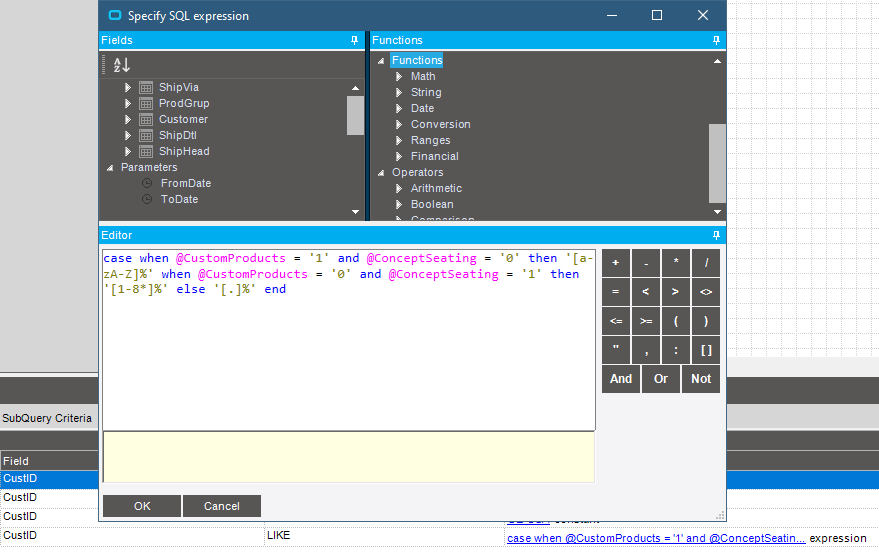

Thank you for verifying. I posted a screenshot of the simple case expression earlier today.
Essentially, I’m using the checkboxes to allow users to filter by brand. For one brand, we use CustIDs that start with a number, for the other brand, CustIDs start with a letter.

I found the solution to my particular problem. I can leave both the ‘mandatory’ and ‘Skip condition if empty’ boxes of the bit paramters unchecked and then set the default value to ‘no’. This allows them to be available in the expression editor, and still be actually usable as expected on the pop-up when running the BAQ.
