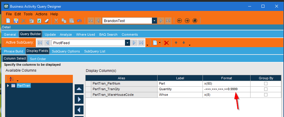

BAQ not displaying full decimals
I’m working on a BAQ that gets exported and sent to our suppliers. In it we have a number of fields that have decimals that go out to 4 digits. They appears four digits on the input screen and seem to be traveling through the system as 4 digits.
However, when I put them in a BAQ they only come up as 2 digits. We need the full four digits to display as they refer to industry specific measurements that are needed by our suppliers and the fact that they don’t is causing problems.
Any advice as to how to fix this?
You control the formatting of the fields here. Decimals default to 2 decimals, but you can put in as many as you want. Caveat, I don’t know how well the kinetic screens respect that, I have seen a little weirdness with formatting, but I haven’t used it enough to say for sure.
Thanks. I knew it was something stupid I was overlooking, but sometimes you just need it pointed out.
