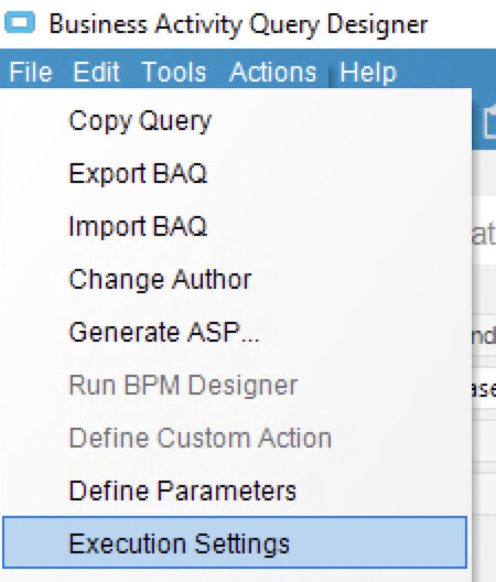

In the BAQ, go to Actions->Execution Settings:

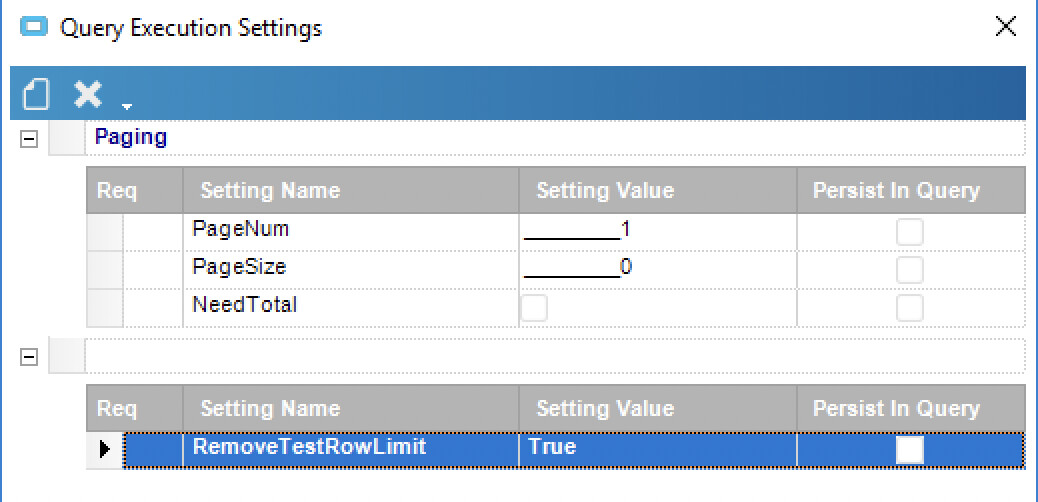

Click on the Add button:
In the row that was added choose the following setting:
Click OK and then run your BAQ again.
