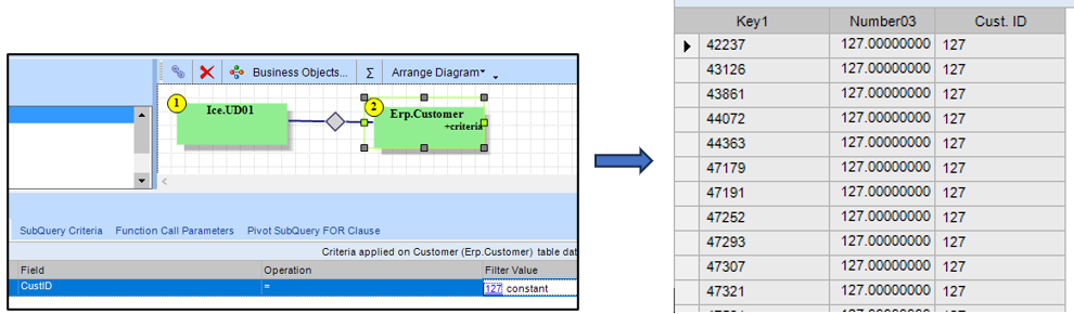

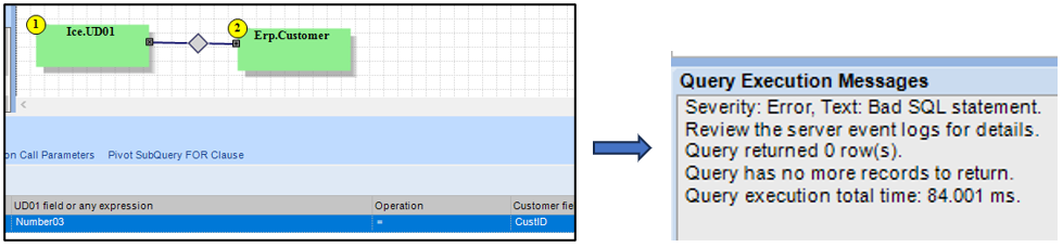

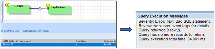

What’s odd is… a straight Number03 = CustID… fails:

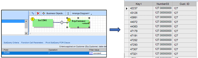

…but, by simply adding a Table Criteria and filtering by a specific CustID… the query works:
I can’t explain why “filtering” the Customer table with a specified constant would provide results where unfiltered it claims it is a bad SQL statement.

@dcamlin Number03 might work to CustNum if you had that, but not CustID since it is a character field.
In the join use convert(nvarchar,UD01.Number03) = CustID
If you had CustID as one of the 5 key fields then it would already be an string field.
Cast the decimal to int in the join.
EDIT: just noticed you’re trying to join the UD.Num field to CustID, which is a string field. Are all of your CustID’s numeric? If not, you gotta handle that in the table filters or your query will blow up.
Better solution is to use a UD.Char field to store your CustID foreign key instead. Match the system data types, not just whatever business practice your company follows today.

Converting the Number03 to nvarchar resulted in an okay SQL statement, but for some reason resulted in 0 rows.
Natively, the BAQ will join the Number03 and the CustID… (without converting/casting)… but only if the CustID is filtered. That’s why I’m trying to determine why that is the case. Is it converting the CustID to a different “type” when applying a specific constant filter?

Yes, the “constant” thing in BAQs is intelligent to convert 127 to a string if that’s what the field needs.
Yes, I’ve attempted to cast both sides of the join to the same thing… but not getting any results unless I add the filter.
So, even if I cast both values to integer it won’t produce results… unless I add the filter, and then it will give results. I just can’t find a way to do this “unfiltered”.

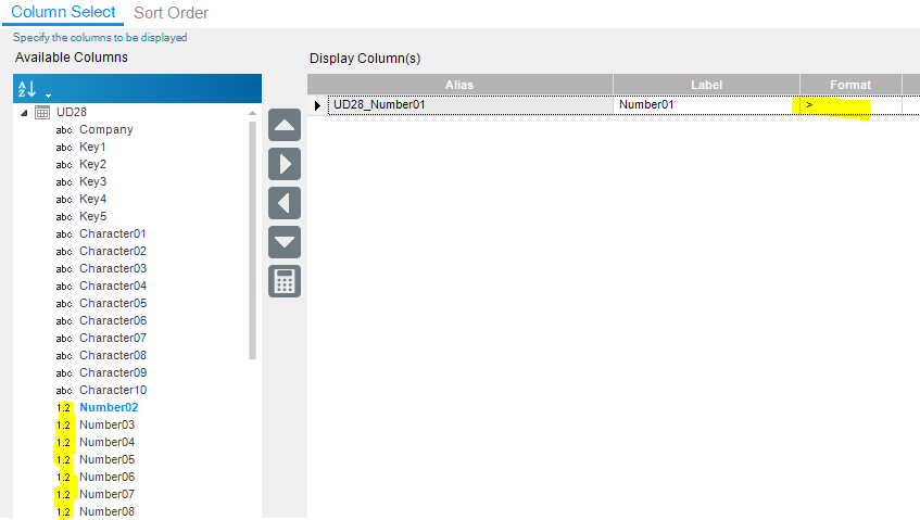

Number01 (etc.) in all my UD tables are decimals (as we’ve discussed at length already), yet come across as single-digit integers. It’s preventing me from entering more digits into the field in an updatable BAQ. I can change the output format, but why is the BAQ being all funky?
