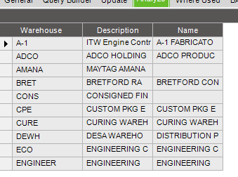

this photo shows me only pulling in data for the warehouse, no repeating data only shows

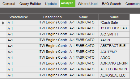

the Warehouse, Description, and Name rows, seem to repeat as long as the name column has a new name. What i would like to know if it’s possible is to keep them all updating while still having them connected.
Then when I add the name field from customer, I get this

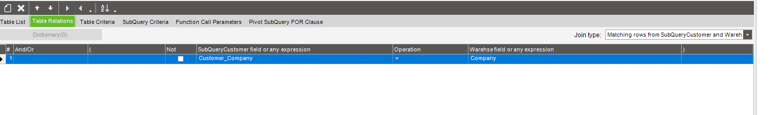

I think me trying to use warehouse, and customer tables are a bad example for what I’m trying to do, but I have connected them only by company, under table relations.
What you created there is called a cross join. Every match on the first table, to the second table brings in a row. And since every warehouse record in the company matches every customer in the company you can all kinds of duplicated rows. If you have 5 rows in the first table and 10 rows in the second table, and join them by nothing, or something that they all have in common, then you get 5 x 10 = 50 rows. You need to be able to join on enough fields to get a 1-1 relationship (if that’s what you are looking for)
