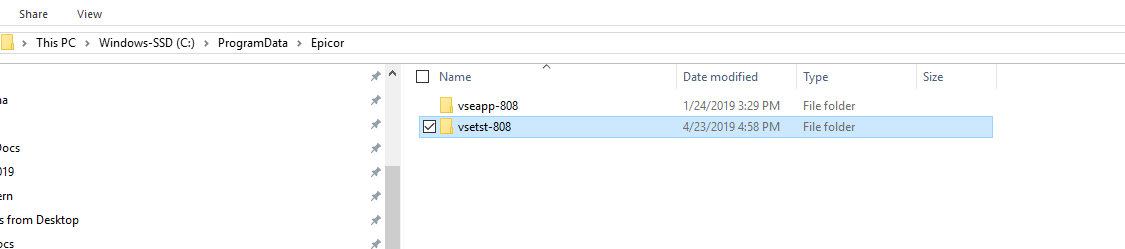

  • Close your Epicor.
  • Clear your cache from C:\ProgramData\Epicor
  • Log back in, re-deploy your dashboard and try again.
This is all I see:
