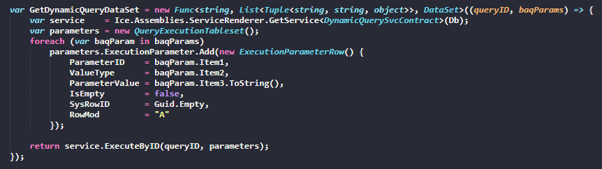

Not that this is correct, but I recently had some troubles with calling BAQ from a customization. Only differences between my customization and my playground/test area was potentially my isEmpty parameters and my RowMod which I left “”.
It was something I didn’t get time to play around with. But perhaps what you are experiencing as well?
Also, never dived into exploring this. But are BPMs async in any nature? if so perhaps your BAQ is not returning a value before the BPM checks for results
The only difference I have in my BPM that calls a BAQ is
SysRowID = Guid.Empty

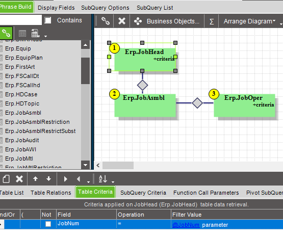

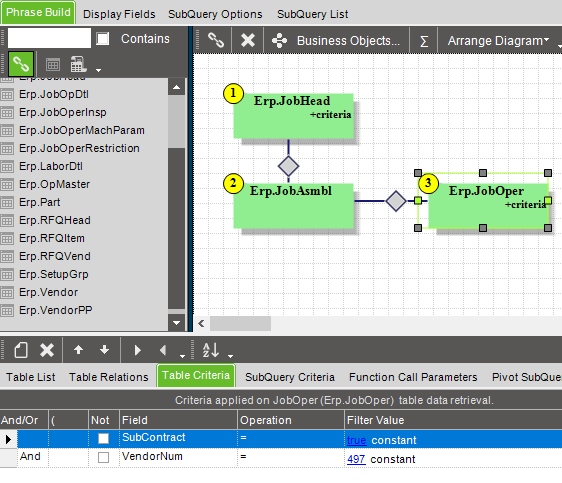

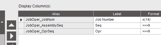

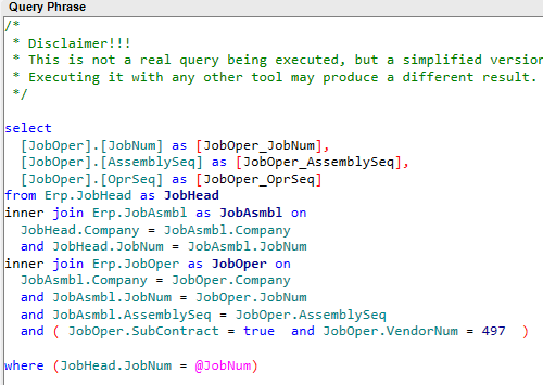

@CasterConcepts, Can you show us your BAQ (screenshot of query builder is fine) and let us know the business objective?
I think this is more of a data structure issue than a code syntax problem… For starters, JobProd does not have “Subcontract” and “VendorNum” fields…
@TomAlexander, I’m sorry, I said JobProd but I meant JobOper.
The objective is to only find subcontract operations, the vendor being one of our other companies, there will only be 1 of these ops per job and not all jobs have this operation.
