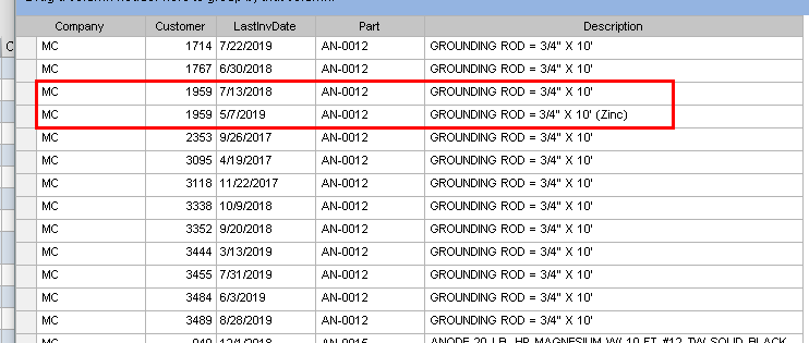

But an issue you might run into is that the LineDesc may be different on different invoices.
So if you had invoices with the same PartNum, but non-identical LineDesc’s, these will show up as two different rows in the output - and would appear as two different “last dates”.
Make the BAQ and Report sort by Customer, then PartNum, and look for rows of duplicated Customer and Partnum

here’s an example:
One of the invoice to Custnum 1959 had a different line description, so that Partnum shows up again for the customer.
Yes, if this is the case for you, then I would link the Part table to the InvcDtl table and get the current description from there.
