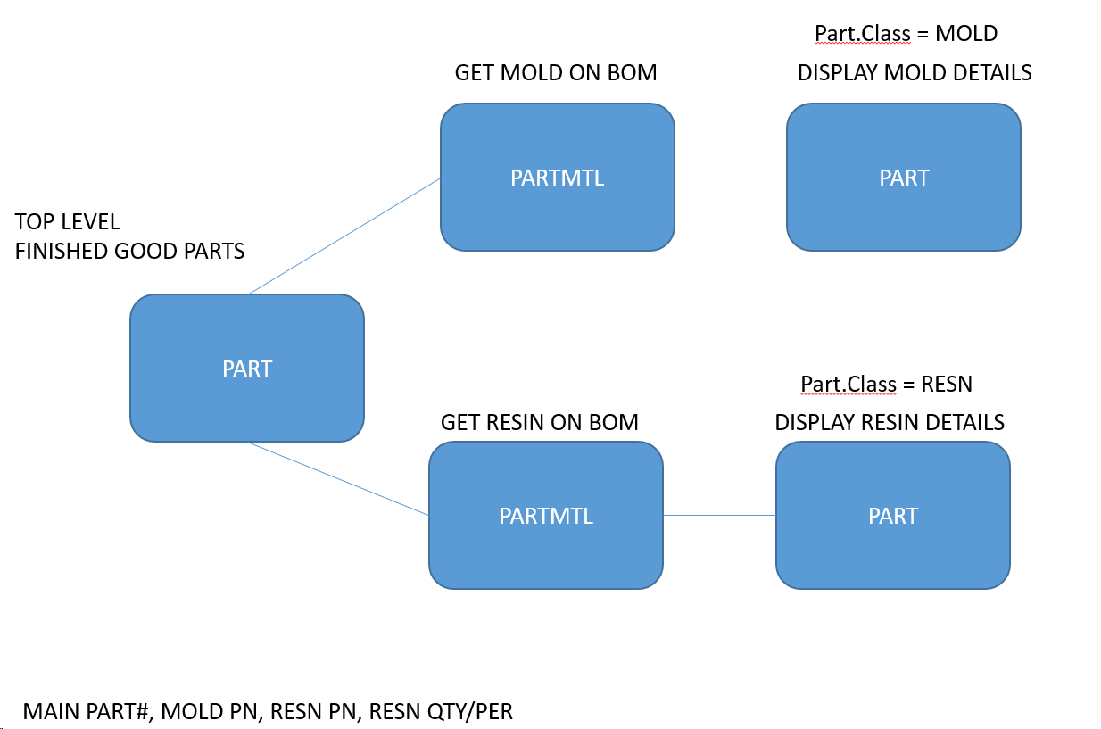

My advanced BAQ building skills are pretty awful. Can anyone offer help explaining how to achieve the following in a BAQ.
Display all top level PN where CLASS = FG. For each of those records, display PN from BOM where CLASS = MOLD, and display PN and QTY\PER from BOM where CLASS = RESN
I used a subquery and I can easily get either of my subparts (RESN or MOLD) but getting both is a little trickier.

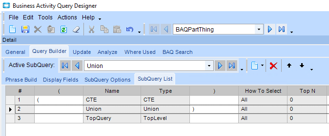

Have 3 subqueries in total, TopLevel, CTE, and UNION
CTE and Union both look the same except one filters for Class 1 and the other one filter Class 2
Union
Then the Top Query just uses the CTE/Union and can be joined to Part
and it returns Parts that Material with class HDW and PWR

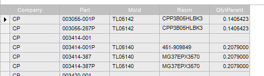

Very nice. Is there a way to have results from both PartMtls (HDW, PWR) on the same line top level?
Like this
Add a calculated field and use a case statement then group by

Yep, only 1 class MOLD and 1 class RESN per top level part
OK. So using an inner subquery works… (if there is only 1) you’ll need 4 inner subqueries if you want to get values for both the MtlPartNUm and the Qty Per, the example I attach only uses 2 subqueries since I am just returning the Mtl for Class1 and the Mtl for Class 2 you’ll have to add more subqueries in the same vein to add more fields.

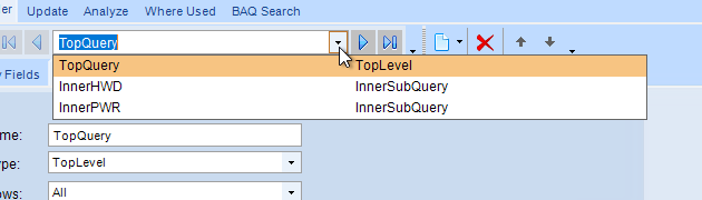

Have 2 Subqueries InnerHWD and InnerPWR
Which are actually not used on the Top query as a Join
But rather in calculated fields, these inner subqueries can only return 1 field to work this way so you’ll need 4 if you want to get 2 values from the PartMtl table
