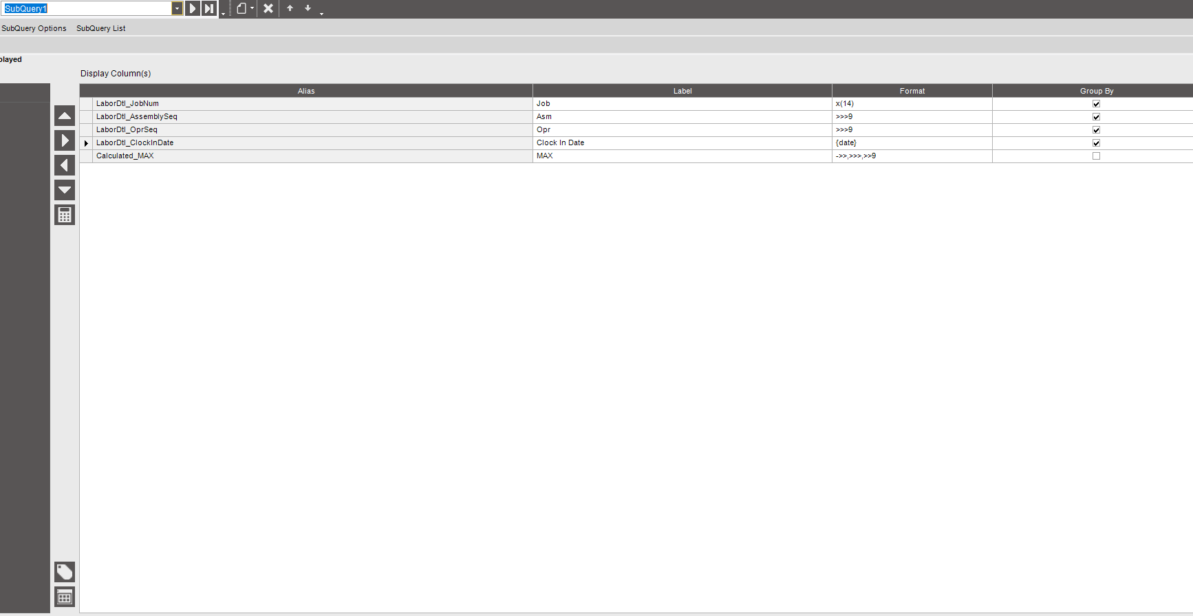

Okay, I have a dirty way of doing it, if you are interested. Essentially it is going to be 3 sub queries. The first (SubQuery1) is your labor detail, which is grouped on Job,Asm,Op, Clock In Date, and also a calculated field. It looks like the following:
The calculated field is an integer that adds the Year, Month, Day, and Opseq, like this:
The second query (SubQuery2) pulls in the above query, and groups on Job, Asm, and Clock in Date, and has another calculated field, which finds the Maximum value from the calculated field above. It looks like this:
Finally, the last query (SubQuery3) joins the two queries from above on Job,Asm,Clock In Date, and the 2 calculated fields. You can then display all the data, and it will only show the maximum operation for each date. The join in the final query looks like this:
Does this all make sense?

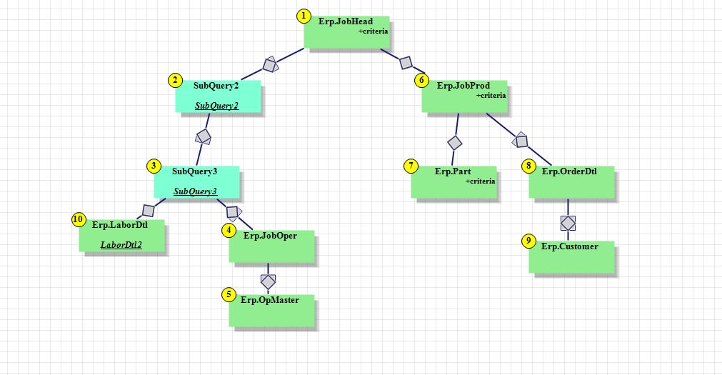

by child parent are you referring to my jobhead and subquery2 in the picture above? im not the most well versed when it comes to the full on jargon of Epicor so please bare with me!
As for what tables im joining, BOTH sub-queries are LaborDtl. Sub2 is pulling max (labordtl.clockindate) and sub3 is pulling (LaborDtl.OprSeq) . I have those connected to each other with table relations of Company/JobNum/AssemblySeq.

So the 1st query pulls in all jobs and operations. It adds a unique calculated field that is an integer to associate with each record.
The 2nd query then finds the maximum of that calculated field from the 1st query, and pulls in the job asm and clock in date that matches that number.
Finally the 3rd query connects the 1st query to the 2nd query, linked by the job, asm, clock-in date, and that calculated number.
The 3rd query will display job, asm, your max operation, clock in date. You can then link this to the other tables above.

Is the left side of the query above (SubQuery2 and SubQuery3) calculating the maximum operation currently?
alright ill try and attach your subquery3 to the rest of my baq and let you know.
if youre asking about my picture then yes those 2 subs are used to pull the max(clockindate) and max(oprseq)

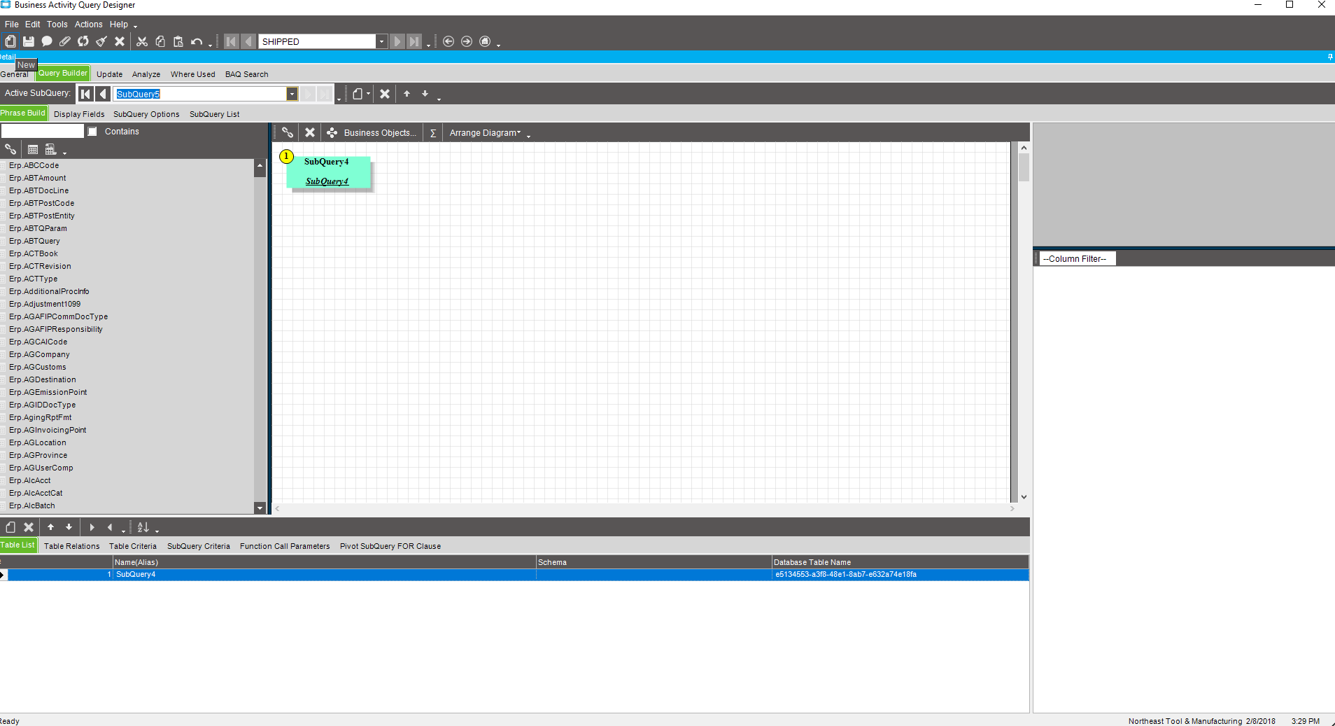

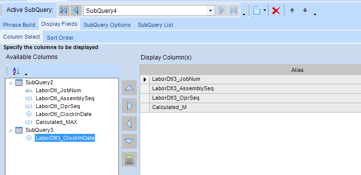

so i added your 3 subQueries to my main BAQ. On the display fields for SubQuery4 (the combination of your two other subqueries) i have the following:
now im trying to pull SubQuery4 into the Toplevel of my BAQ but i keep hitting roadblocks.
Any advice as to what relations i should link them by or let me know if i just linked this all wrong.

i noticed though that i havent actually added anything from the final subquery to my top level.
Sub1 is my top level
in Sub2 we create Calculated(MAX)
In Sub3 we create Calculated(m)
In Sub4 we link Sub2 and 3 and relate MAX = m
Should i be adding calculated(m) to my top level? or am i missing another step in between?
I was looking over it again, can you verify on Sub2 that the calculated field is this?:
datepart(year,LaborDtl.ClockInDate) + datepart(month,LaborDtl.ClockInDate) + datepart(day,LaborDtl.ClockInDate) + LaborDtl.OprSeq
