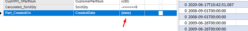

I’m also seeing that even tho I have this last column marked as a {date} it’s still exporting {datetime}. Bug?
Even as a calculated column, I get a time component added when running it via BAQ Export.
Thoughts? BAQ Export does something different? So strange and frustrating.
