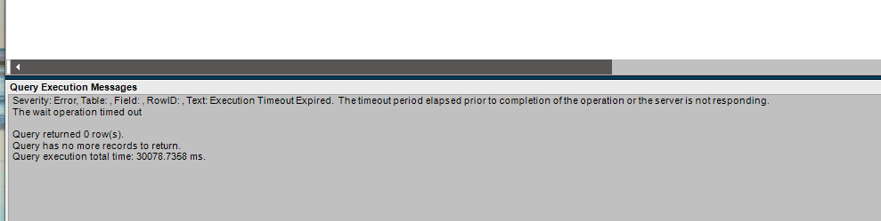

I’m getting the below error on a baq. I’ve tried adjusting the timeout and still will get this error. Any ideas?

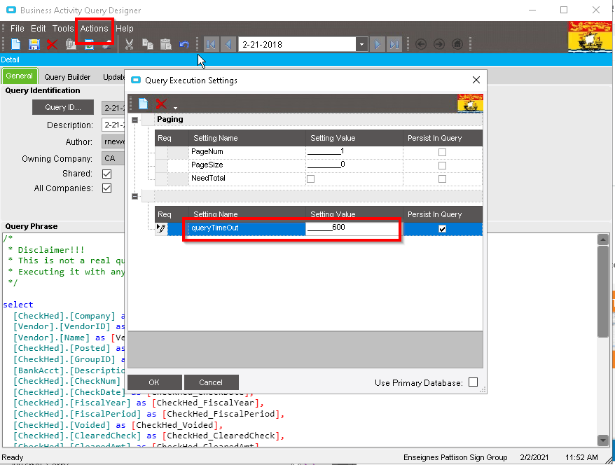

You could also try increasing the query time out in the BAQ. Under actions menu select Execution Settings. Add the QueryTimeOut parameter, 600 was recommended to us and it works well whenever we run into thi

Your suggestion worked for me. Curious on why you selected ‘600’? I’m a newbee, so still learning the ropes. Thank you for your contribution!
It was suggested by support, I have used larger numbers on some very large and slow BAQ’s but the 600 seems to work on most.
