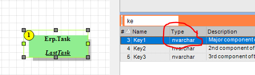

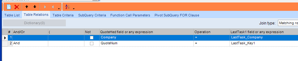

There is a relationship between Erp.QuoteHed and a subquery called LastTask.
The link is QuoteNum in QuoteHed equal to LastTask_Key1 in (my subquery called LastTask that is only Erp.Task table).

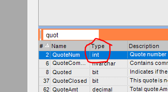

Key1 in Task table is nvarchar:
QuoteNum in Erp.QuoteHed is type int

The other (probably right thing) to do then would be to cast your type in the join. You can type in those boxes and force the int field to be character.
