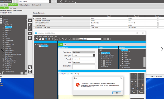

I think I’m ok with the filtering to get owner vs. group but how do I get the total? I tried a Calculated Field using Aggregate >Count but get errors referring to grouping.

I can’t say I fully understand why I have to group by OrderNum (would it not be unique anyway?) in order to count the lines on each order so I’m still getting an error and not able to set up my solution with Total Open Cases.

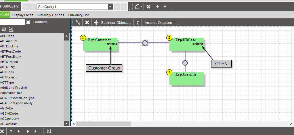

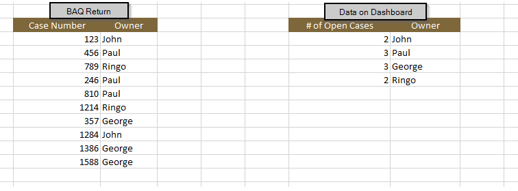

I am including screen shots with some notes/ labels on them that will hopefully clarify what I’m trying to do. I’m really looking for Summaries but I want the result in a cell instead of at the bottom of the column.

As soon as a subquery uses an Aggregate function (COUNT(), SUM(), MAX(), etc…) all other non-aggregate fields in the subquery must be marked Group BY

And there’s no requirement for the Summary BAQ to drive the details BAQ. You could have the Details BAQ as the primary one, and the Summary driven by it. But that doesn’t flow logically. The Summary would only show records for the matching row in the details
-----Details BAQ pane-----
CaseNum  Owner
    123  John
>   456  Paul  (selected row in primary pane)
    789  Ringo
    246  Paul
    810  Paul
   1214  Ringo
   1284  John
-----End of Details BAQ pane-----
-----Summary BAQ pane-----
Num Cases  Owner
        3  Paul
-----End of Summary BAQ pane-----
Selecting either John row in the upper pane changes the lower pane to
Num Cases  Owner
        2  John
Where as if the Summary was the primary BAQ, you’d see something like:
Num Cases  Owner
        2  John
>       3  Paul (selected row in primary pane)
        2  Ringo
