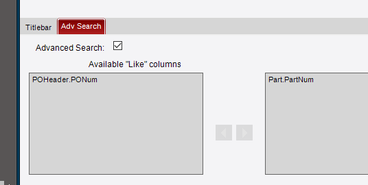

Did you double check the “like” field setting in your dashboard to make sure Serial number is still selected there?

The Context Menu Maintenance, Extended Properties Maintenance, and the “like” field settings (in the dashboard) mentioned above are all set correctly.

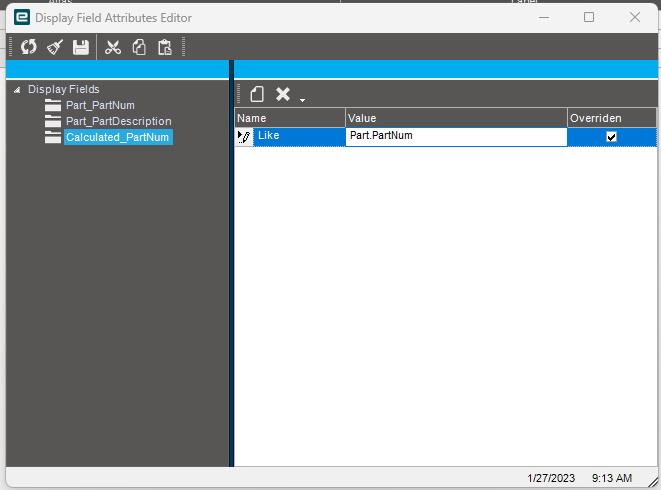

Also, if you need to add a “like” context menu to perhaps a calculated column, this can be done through the Field Attributes Editor
