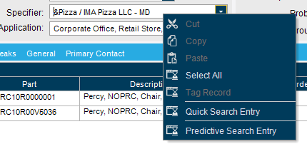

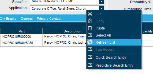

Does anybody know of a way to get a BAQ Combo Box to “Refresh List” within a C# customization. Normal EpiCombos have an option to “Refresh List”, seen below, but BAQ Combos do not. Because of this, the thought would be to do so with code, so users do not have to exit out of the form and re-enter to have new data enter the BAQ Combo.
