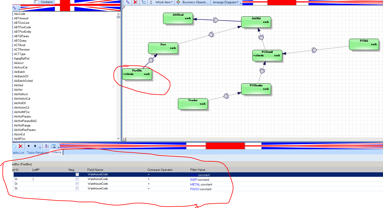

Hi guys, i’m hoping this is a quick one…I have a BAQ where one of the tables is PARTBIN, I have criteria applied to the table as per the screenshot below…i basically want the BAQ to display a SUM of the partbin.onhandqty of the warehouse codes applied
At the moment, i have just brought in the field into the BAQ and it brings the correct data, but multiple lines as it brings in a line for each binnum.
All, i want is one summed total (so add onhandqty for the 4 warehouse codes and return me the answer)

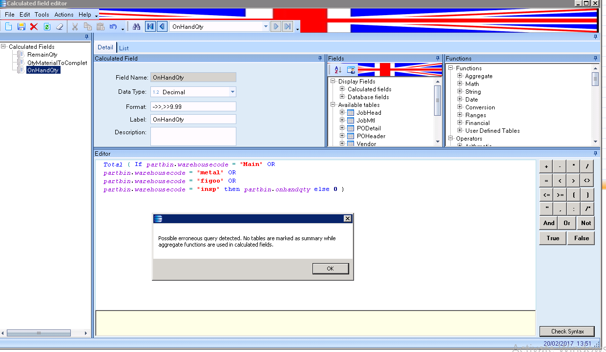

I tried making the PARTBIN table “issummary” but got the error “Possible erroneous query detected. One or more tables marked as summary while no aggregate functions are used in calculated fields.”…i then tried taking the field out and adding a calculated field using the below…but then the numbers it returned were nonsense…i couldnt make sense of them at all.
I think i’m doing something basic wrong, but not sure what.

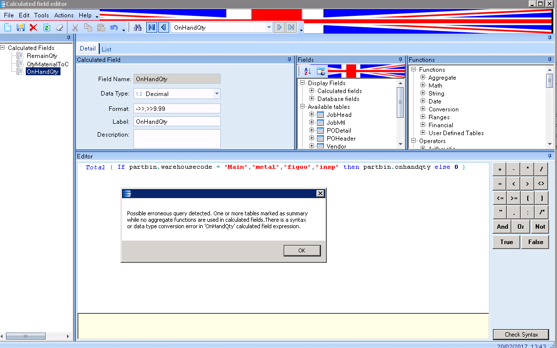

I just tried writing the below syntax but got an error!
this didn’t work either…

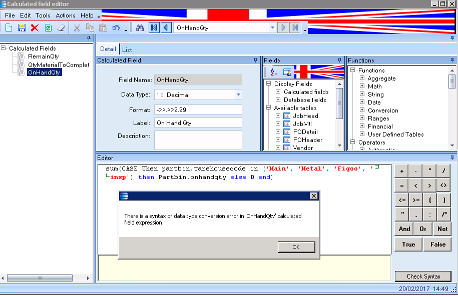

Have you tried a case instead of if?
sum(CASE When partbin.warehousecode in (‘Main’, ‘Metal’, ‘Figoo’, ‘insp’) then Partbin.onhandqty else 0 end)
Hi Knash,
it returns a syntax problem
Can you close the calculated field box. Goto the General Tab. Copy and past the query phase here. That will help.

Are you looking for the total in each bin in each warehouse or the total for that part in each warehouse? PartWhse.OnHandQty would be another route.
Patrick Winter
for each JobHead no-lock , each JobMtl no-lock outer-join where (JobHead.Company = JobMtl.Company and JobHead.JobNum = JobMtl.JobNum ) , each PODetail no-lock outer-join where (JobMtl.Company = PODetail.Company and JobMtl.PartNum = PODetail.PartNum ) and PODetail.OpenLine = true Or ISNULL(PODetail.OpenLine) , each POHeader no-lock outer-join where (PODetail.Company = POHeader.Company and PODetail.PONum = POHeader.PONUM ) , each Vendor no-lock outer-join where (POHeader.Company = Vendor.Company and POHeader.VendorNum = Vendor.VendorNum ) , each PORel no-lock , each Part no-lock , each PartBin no-lock outer-join where (Part.Company = PartBin.Company and Part.PartNum = PartBin.PartNum ) and PartBin.WarehouseCode = ‘MAIN’ Or PartBin.WarehouseCode = ‘METAL’ Or PartBin.WarehouseCode = ‘INSP’ Or PartBin.WarehouseCode = ‘FIGOO’ outer-join where (PODetail.Company = PORel.Company and PODetail.PONum = PORel.PONUM and PODetail.POLine = PORel.POLine ) outer-join where (JobMtl.Company = Part.Company and JobMtl.PartNum = Part.PartNum ) by JobHead.PartNum by JobHead.JobNum by JobMtl.PartNum .
i am looking to get the total on hand quantity from the following warehouse codes…main, insp, figoo, metal…i want it to return it the TOTAL on one line.

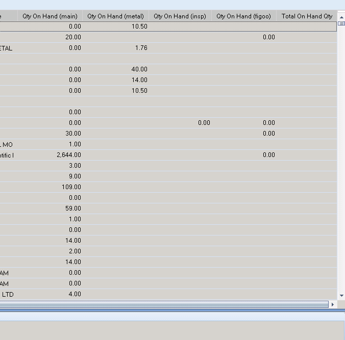

I’ve gone with Patrick’s suggestion…it gives me more columns - but i can live with that…it seems to work.
thanks for your help guys.
Today, has to be the worst day ever with BAQs!!!
The TotalOnHandQty field doesn’t populate any numbers in the analyze tab!
