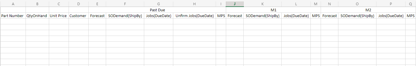

I’ve been asked to build a “Supply and Demand Summary” baq / dashboard. The baq is to go out and get our forecast, sales order demand, and our firm and unfirm job qty’s by part number. After all that data is collected I need to put those quantities into buckets:
Past Due - everything that was due before today and is still open, and then everything from the current month to 12 months out from the current month.
The end result should be formatted similar to the following:

What I would like to do next is pivot out the information in the baq to match the above image.
