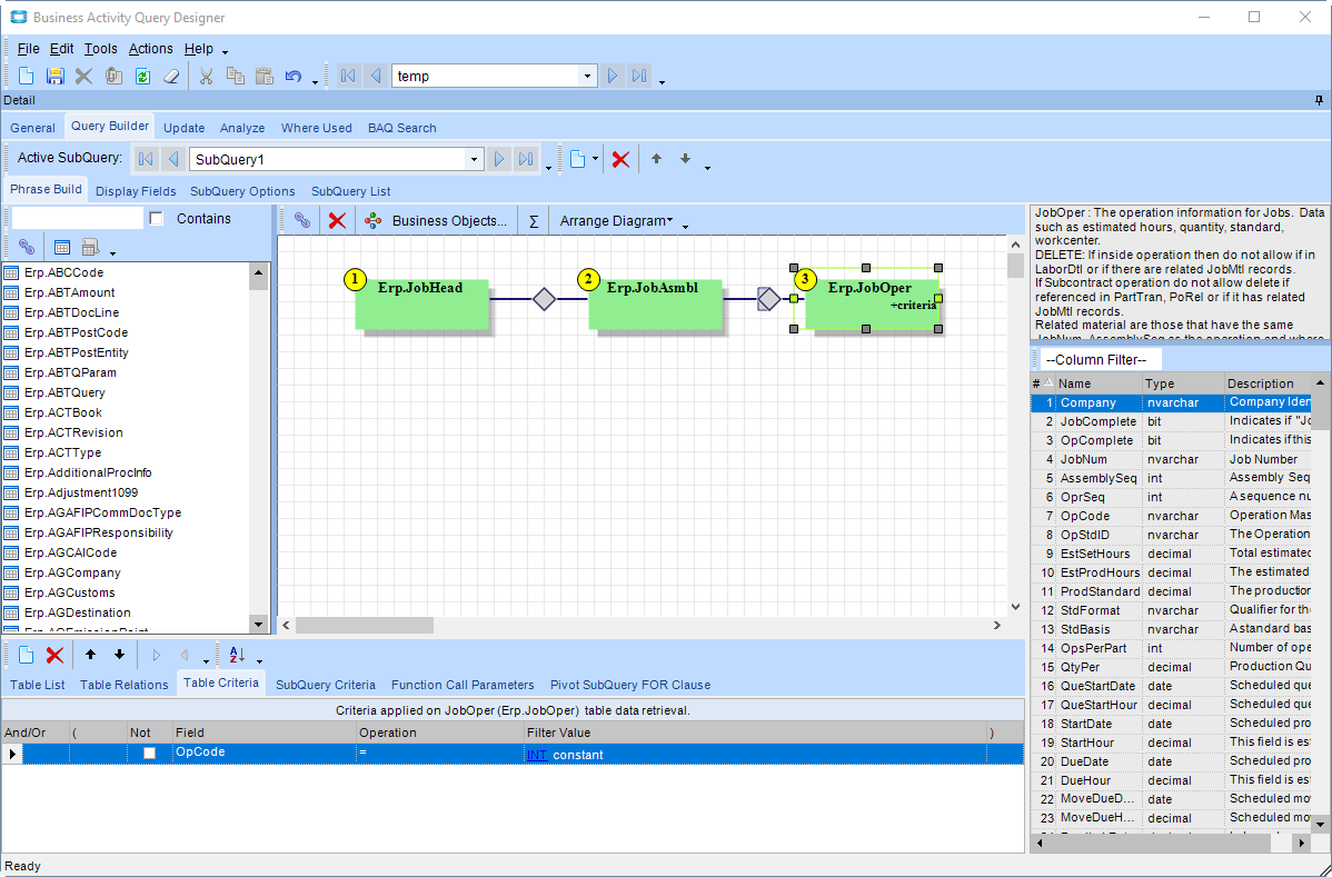

I want to display the jobs that dont have the OpCode = INT
I have Job Head to Job Asmbl to Job Oper…but when I add JobOper it displays all the Operations, so I get X times data…
IF job contains INT, dont display it. How would I do this?

There is a NEG checkbox that makes the CONTAINS or = negative. From the Help: Neg
Select this check box if you want this criterion to evaluate a negative value.
You may also want to try setting the operation table to only pull in the
first or last instead of each operation.
Brad
If I do Last or First, it wont pick up INT because it is neither first or last.
If I do the NEG, which I tried. it still shows me all the other ops, so it didnt show me the INT op which is fine, but at the end I want the Job to be displayed once.

Left Join on the JobOper table with a Table Criteria where OpCode = ‘INT’
SubQuery Criteria where OpCode ISNULL…
