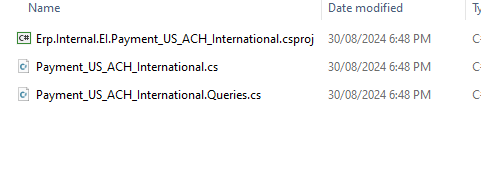

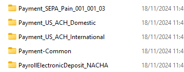

If you are on prem, all the files are there in the server/erp/ei folder. in there there is folder for each interface which is a VS studio project for each one
There are examples and there are also other examples on Epicweb for earlier versions that you can download (your mileage may vary)
Disregard my comment of the examples, they appear to be there already, at least in my On prem install.

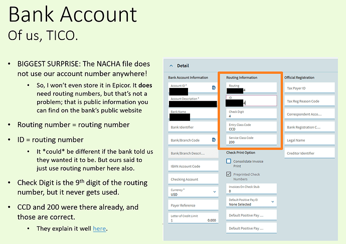

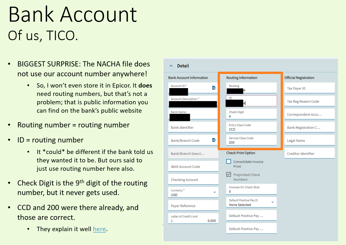

I had wrote up a PPT, but it has sensitive info.
We didn’t have to do anything outside of Epicor. I think I learned everything here on this site.
And EpicCare: EpicCare Login - EpicCare
Bank account might have been the trickiest part:
