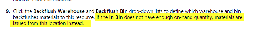

What’s the In Bin set to?

My question about the “In Bin” is because …
since we don’t have our resources or resource groups set as auto move, we don’t use the in or out bin (They are read only). Just the backflush bin.
