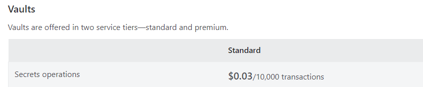

Well, we kick the can a little further down the road here. The ideal situation is the secret is not at the server but kept in a vault. In order for the API server to get the secret, there’s a pair of digital certificates that allows the API server to retrieve that secret. The API server will retrieve it each time it needs it. (A better practice would be that the secret gets rotated each time it’s used much like Microsoft does with Local Adminstrator Password Solution - LAPS.) Obviously, one has to balance the risk appetite with the effort. But using a BFF that gets the credentials from secret store is enough juice that’s worth the squeeze.

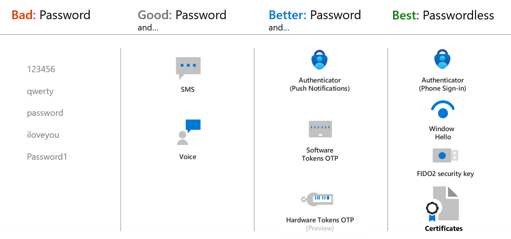

As for humans, here’s some nice weekend reading on how passwordless works for our users by passing challenges across multiple channels while using public key cryptography behind the scenes. No passing around secrets.
