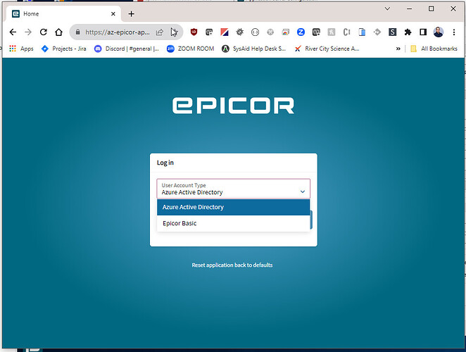

That’s odd the new version of the browser prompts us for either Azure or Basjc out of the box they must have something configured incorrectly in their setup
I’d escalate that the current 2023.x version definitely has the ability to prompt it even does it in EMWW and Expense Apps and we didn’t have to configure anything special on our side just enable Azure AD and Basic.
In the browser (and apps) we get prompted with both options now

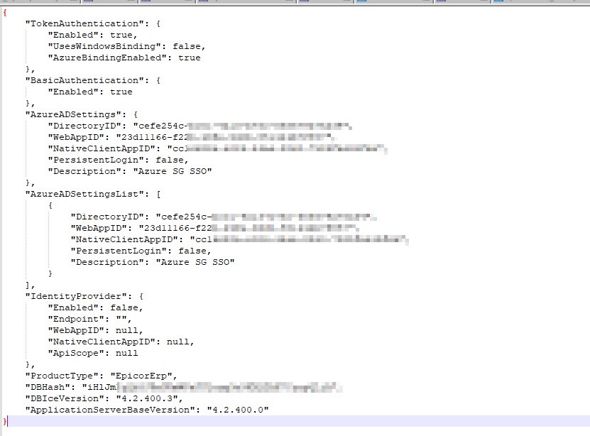

What do you get if you visit
https://YourCloudAddress/YourCloudInstance/api/.configuration?tenantId=
If your azure is configured properly you should receive azure info in this request that’s what sets up the browser / dropdowns should look something like this.

Yes that is what I see on ours too. Like I said if I go to the url with azure method set in the url it works fine. But if the user clicks to launch the browser from the client it forces to basic auth, can’t see why.
