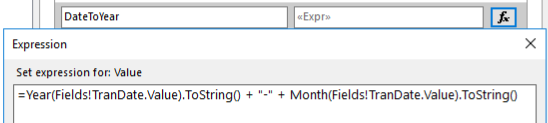

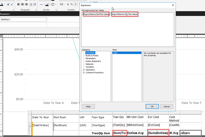

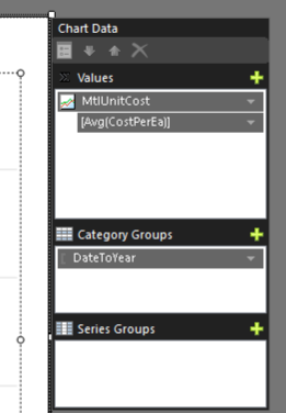

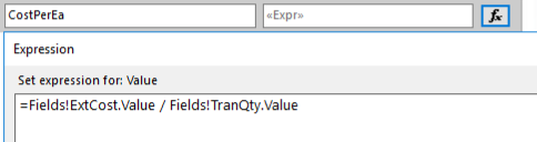

Got an SSRS report started. I’ll have to check for accuracy. I’m using PartTran table which PUR-* (PUR-STK) (PUR-CUS) etc.

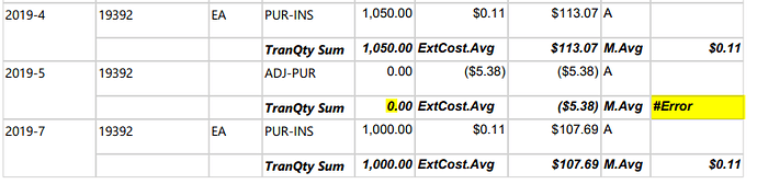

Do you use Inspection Processing? (“PUR-INS”) If so, do you count it if it goes there and fails?

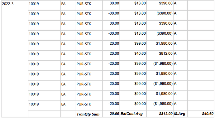

I will have to fix that. Negative PO works (aka unreceiving)

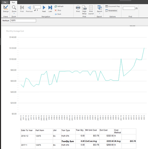

Month average is bottom right which is charted.
$812.00 / 20 = $40.60
:slight_smile:

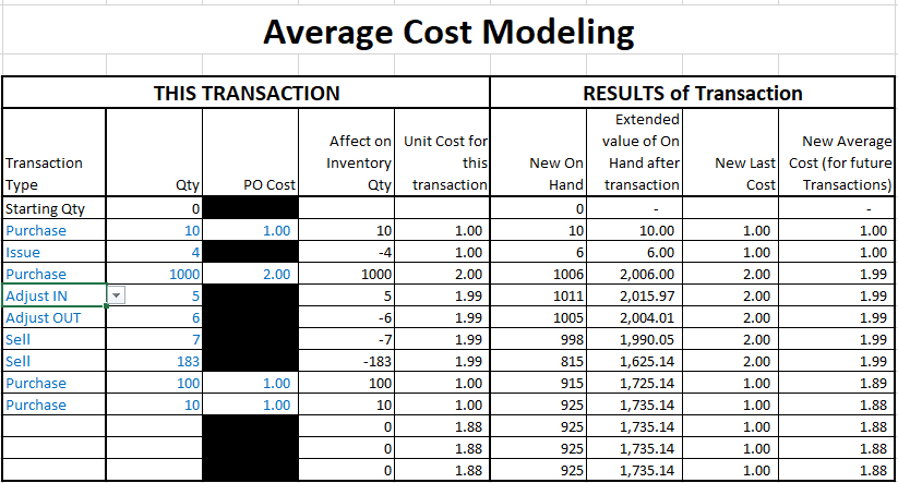

I may have shared this before… but attached is an Excel Spreadsheet that emulates how the Average Cost is calculated. Yes I agree that the term “Average Cost” is sometimes confused by people who were not trained on the old school average costing method… Average is not an average of all the unit costs. Instead it is a weighted average of the total cost of all the units in stock. The formula is:
New Average Cost = ((Old Qty * Old Average Cost) + (Additional Qty * Cost)) / (old qty + Additional Qty)
In other words, if you have qty 100 @ $1 and you just purchased 10 @ $5, the average is NOT going to be $3… it will be a weighted average of $150/105 or $1.429. The new average cost is continually calculated based on the above formula after each and every RECEIPT. Also note that ISSUE and ADJUSTMENT transactions do not change the average cost. Only new receipts will affect the average cost.
This spreadsheet allows you to model these transactions. You can play with the transaction types, quantities, and costs to see the results over time.
Average Cost Model.xlsx (12.9 KB)
