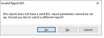

I have started looking at a data directive bpm to auto-print the baq report - it is linked to the ship head table - marking pack slip as shipped already auto-prints the packing slip - however whenever I try and link this I get an error
bpmerror

It was the widget that i was having trouble with as that is where the error occurs.
