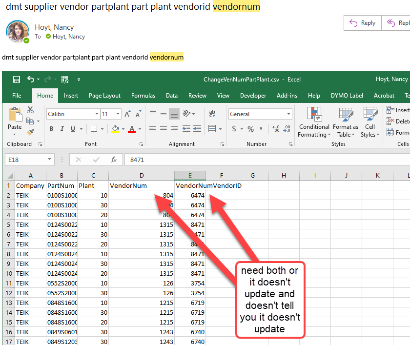

I’m just putting this out there because I have struggled with DMTing the vendor ID on the PartPlant records. It would not provide an error/message but failed uploading via DMT. I needed to provide both VendorNum and VendorID but needed to call that VendorNumVendorID. Any chance you have a fail due to the vendor not getting uploaded properly?
