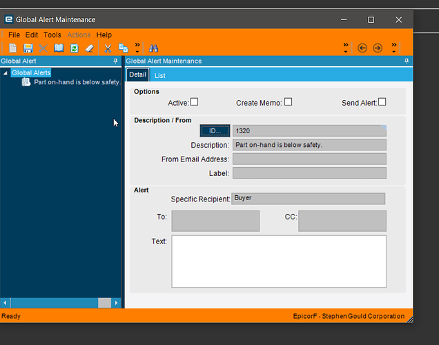

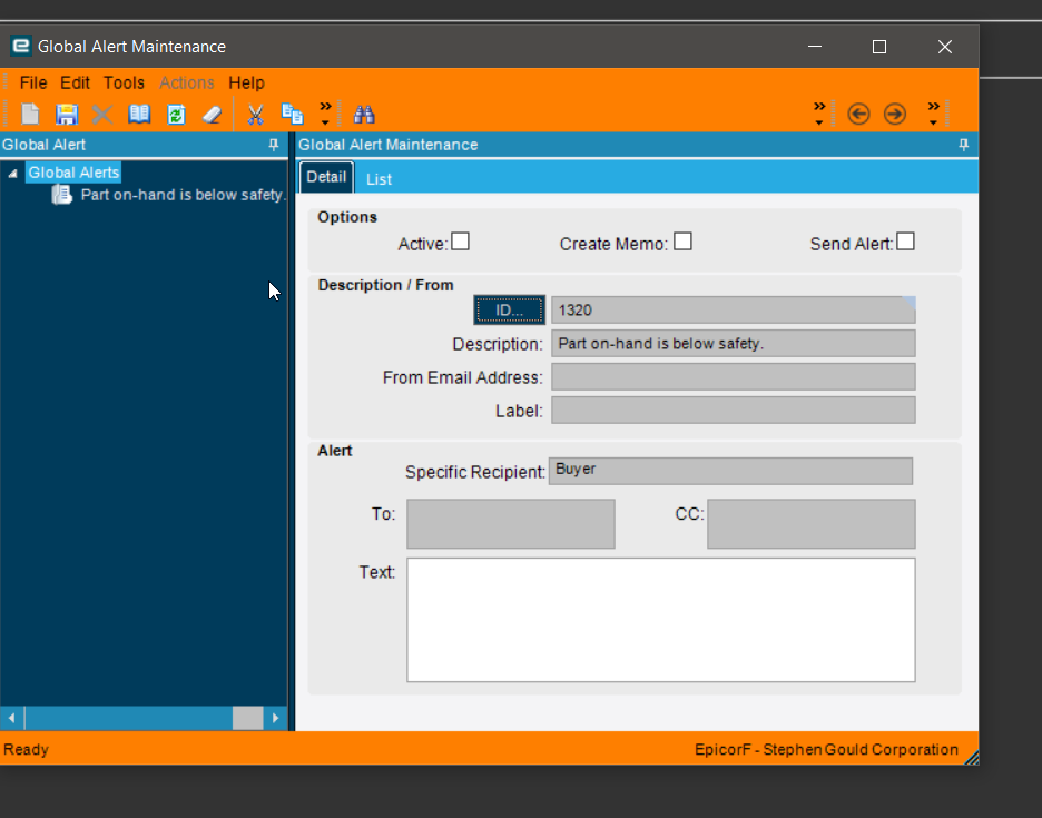

You get it for free with Global Alerts
Thank you…no one had ever mentioned Global Alerts, and I had not seen them to test them.
I will try it out!
