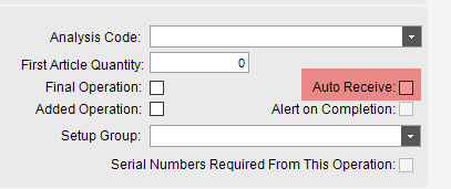

Everything I am reading about the auto-receive flag on the operation in these user guides states that the reported quantity needs to exceed the related sales order demand… which makes me think that this flag has nothing to do with MAke to stock jobs… Been a minute since I reviewed this flag.
Our experience with Auto Receive
Make to stock, will receive any qty entered.
Make Direct, Up to the qty of the sales order no receipt to stock, Anything reported over the direct job links qty will be received to stock. Even if it is greater than the job qty
We do almost all make to stock and auto receive all of them. Any quantity that goes thru the final operation will auto receive.
The one thing I have not been able to control is the destination bin location. It uses the part’s default bin and I have made multiple attempts to flex that without success.
thanks @E102016 and @gpayne , it’s the request move flag on the end activity screen that’s throwing us off. If that’s checked it doesn’t auto-receive.
But then the KB I look up says that the flag is defaulted IF the auto move checkbox on the resource / resource group associated with the final operation has been checked… and it’s not… so why is it checking itself :upside_down_face:
