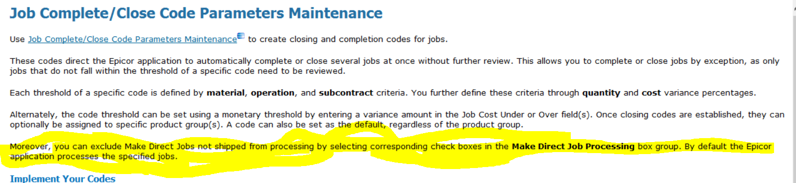

Auto job completion is trying to complete make direct jobs that havent shipped. Epicor Help says there should be a check box to cause the process to ignore these jobs.
anyone else run into this issue or know where this mystery check box is?
Had a look around for the checkbox, and couldn’t find it on the screens:
Job complete/close code parameters
Product Group (where you link the code)
BUT, there are 2 fields in the table:
ExJobsNotShipClosed
ExJobsNotShipComplete
So I would on a TEST system, use an update able BAQ to set these to true, and then test again to see what you get. If this works, then customise the Job Complete/Closing Code screen to expose these fields.
