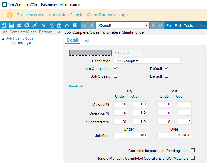

Finance requirements, allowable tolerance +/- 10% and $2000 max. Current parameters in testing are setup like this and I’ve also tested with 10 in all of the qty boxes.

Couple of things to check. First, was the closing code assigned to the Product Group of that Job. Second, I believe a 0 means it will not check that field. Try changing the Under to 1 or something else and see what happens.
Thank you for the suggestion. I reversed the jobs that were flagged as completed from running it the last time and this time through it did not flag anything for complete.
I have the parameters applied to all product groups.

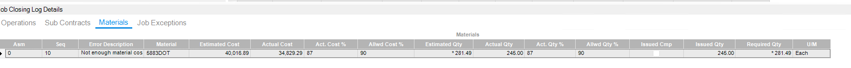

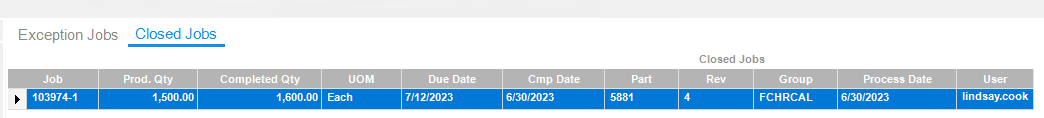

The job was for 1500 and 1600 is what was actually reported. It was a batch job so that is it’s own confusion but it was not expecting it to complete or close.
Since I reported this job through as a test job, it’s fairly close to the right information.
Lindsay, try changing the job to 1600 and releasing it again and then try to run job closing and completion.
That time it failed for the material which I think is what accounting was expecting.
